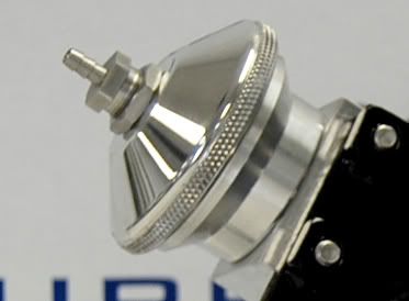

Variable Turbo Specialist
The vanes are operated mechanically via the "controller", which is very similar to the waste-gate actuator on internal wasategate turbos. The controller consists of a diaphragm, piston, spring, and shims. The controller pulls vacuum/boost signal from the charge side of the turbo system (preferably near the compressor outlet) and responds accordingly, adjusting the angle of the vanes to create peak efficiency of the turbine.
![]() The air fitting on the controller is what controls when the vanes begin to activate. A jam nut hold this fitting in place and allows for some adjustment. the spring withing the controller is your main boost adjustment. Swapping out different springs nets different boost ranges which are fined tuned via a series of shims. However if your are comfortable where your boost is and would like to use a manual boost controller, it could simply be installed in-line to the air fitting to act as a bleed-off. This will show the turbo less boost than it's making, in turn building more boost. Personally I'm a fan of setting the boost where I want it and leaving there unless I have a way to adjust fuel maps on the fly as well, but some people like to have adjustment
Collin@aerocharger.com Research & Development The World's Fastest Spooling Turbochargers www.AEROCHARGER.com Last edited by No_Lag; 11-06-2009 at 11:23 AM.. |
