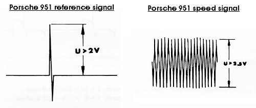

To really check speed/ref sensors, use and oscilloscope and compare the waveforms to the desired signals in the DME/KLR Test-Plan manual.
Would also be a good idea to go through the DME/KLR Test-Plan step-by-step.

As soon as possible I will borrow a friends oscilloscope and check the actual signals from the recerence sensors, check the ignition trigger signals on the coil circuit, the ignition signal from DME to KLR, and the trigger signal from the DME. According to the instructions in the DME-KLR test plan.

Today I checked the sensors with an oscilloscope. Both sensors gave satisfying signals according to the DME test plan. However, the speed sensor signal varied in amplitude in a pulsating fashion.
What is more, I later on the day found out that the speed sensor has connection to ground, something the reference sensor does not. I found this out by chance when checking the ground terminals on the DME and KLR connection plugs to verify good ground. I had one multimeter probe connected to the negative battery pole, and the other probe connected to the different pins on the plugs. I got the following readings:
2,3 Ohm on DME pin 27 (speed sensor)
883 Ohm on DME pin 8 (speed sensor)
What can cause this?
I first thought it had to do with the wiring harness, but when disconnecting the speed sensor from the harness the readings went away. I therefore proceeded to check directly on the speed sensor plug and keeping the other probe on battery negative. I then got the same readings as described above. This means the sensor itself shorts to ground. How is that possible? By the sensor touching the clutch bellhousing? The sensor is new, and the wiring on it is intact. I see no apparent errors with it or the way it is bolted to the sensor holder.. Ideas?
Lastly, today I for the third time had to swap the connections on the reference sensor and speed sensor to get it to try starting. Earlier I have always been certain I had the connectors on the correct way, but when there were no indication of running I swapped the connectors and got the firing I have described earlier (Sounds like the ignition timing is off). I assumed both times before that I had just connected wrong. Today however I checked time and again that I had the proper connectors going to the correct sensors. But I had to swap them to get the engine to attempt starting (As before).
HOW IS IT POSSIBLE that when the connectors are on as they should be, I get no firing at all. But when reversing the connections (Ie putting the reference sensor connector on the speed sensor and vice versa) I get firing and attempts to start? Has anyone experienced this before?
The fault is not in the wiring harness, because I have checked continouity on the wires today and verified that the pins on the DME plug corresponds with the sensor connectors on the other end of the harness. So again, the DME does not even try to start the engine with the sensors connected the way they should be. But when reversing, in other words letting the reference signal be sent to the speed signal input on the DME and vice versa, it tries to start in the fashion described since I started this thread....

Well, as it turned out it was the speed sensor that was the problem. Although brand new, it shorts to ground. A wire inside must be touching the outer metal casing. When I borrowed another sensor from a friend, the engine fired right up with no fuzz whatsoever! :-)
Leasons learned:
- Even brand new sensors can be bad
- Although "everyone" says the engine won't fire if the connectors for the flywheel sensors are reversed, it might just do that. That was indeed the case for me.
- A sensor can be bad even if it gives ok readings on a multimeter (resistance measurements) and an oscilloscope. The final check should then be wether or not the sensor has continuity with ground! (it should not if it is ok)
