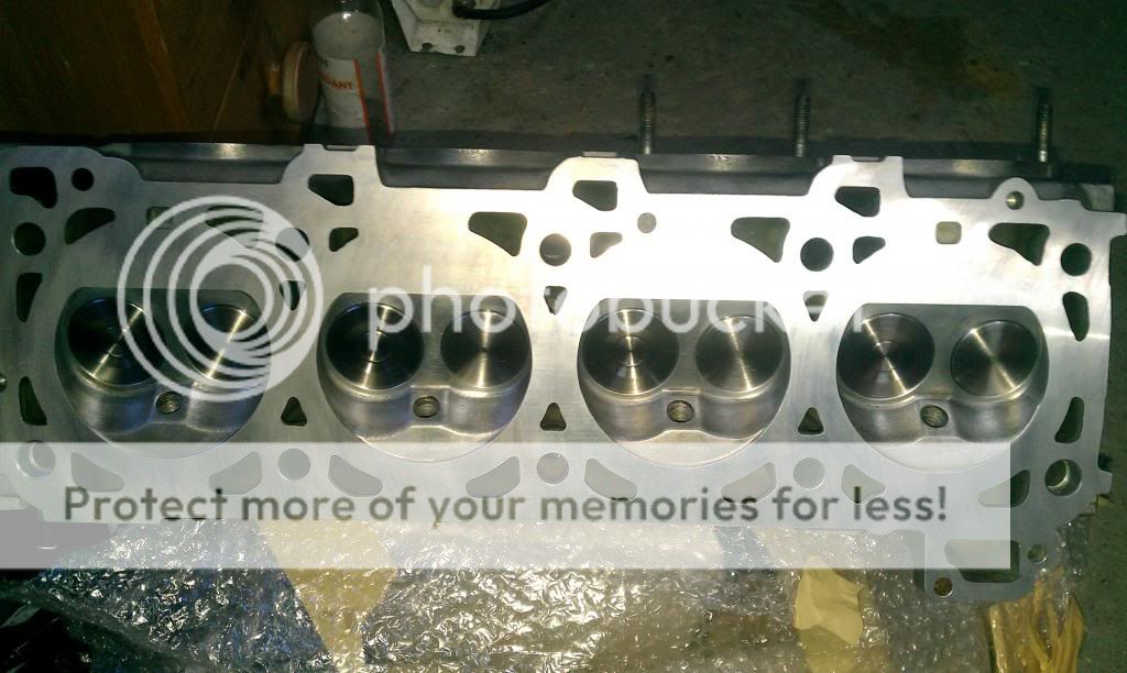

Hi folks
I have just completed my rebuild (1986 944 Turbo).
When trying to start the engine, it sputters, misfires and backfires, and simply refuses to start. I got it started for a minute or two today, but had to use the Accelerator to keep it running. It poured out black smoke (But I have used thermal coating on both inside and outside of the catback system, so some of the smoke was probably just paint curing.
I have checked that I have spark on all plugs, and that I have fuel from all injectors.
I have renovated the entire engine wiring harness. So I am wondering if there might be a wiring related problem(Bad connection somewhere, wires swapped, or similar)?
Furthermore, I have installed a Rogue Tuning A-tune chip together with the accompanying MAP-sensor. I have also installed the required 3-bar FPR that is needed with this chip. The injectors are rebuilt by Witch Hunter. They have sat for a while before being installed (Bought them of a fellow Porsche enthusiast because he didn't need them for his Project after all), but the injectors had been treated with some sort of lubricant to prevent them seizing upon Storage.
I have renovated/checked both the AFM and TPS according to online-instructions, and rebuilt the entire TB. The turbo is a professionally rebuilt K26/8.
Any thoughts? Could the ignition timing be off? There is no adjustment possible that I am aware of. I have tripple checked that the firing order is correct.
I have tried swapping the flywheel sensors, so have confirmed they are installed correctly. As mentioned I have verified spark and fuel on all cylinders. But all brand New plugs had Heavy black deposits after the starting trials...
So far I am clueless as to what to check NeXT..

It could be one or many things. You probably should have got it running and then rebuilt or replaced one thing at a time and gone from there. You are going to have to make sure that you put the timing belt back on the correct way if not you have bent some valves and who did the head work and what did they do? Do you have fuel and spark? There is a way to see if your injectors are pulsing like they are suppose to with a noid light. I would go to Clarks garage do some reading and eliminate components one at a time and narrow it down for starters. My 2 cents.

A reputable machine shop did the head rebuild. They are known for their head-work, although not specifically with these engines. Mostly Ford Cosworths and BMWs. But they seemed very competent. The head has been resurfaced. The exhaust valve guides have been replaced, while the intake valve guides were ok. The valve seats have been re-cut with a multi angle method that is to be superior to the stock design. The valve stem seals have been replaced.
I double and tripple checked my work when installing the timing belt. So I am fairly sure I did it correctly. I used ArnWorx's belt tensioning tool. I rotated the engine by hand several times after installing the belts, and there were no intereference issues between valves and pistons. Marks ligned up again after manual rotation.

Looks like they did a nice job on your cylinder head. Any idea how much it was decked? I would next make sure you are getting proper fuel pressure by puting a gauge on the end of your rail or using the hose into jug method to rule out a fuel pressure issue. You installed new intake gaskets etc right? Are you sure that you have the plug wires going to the correct plugs? I would next get a noid light or send your injectors out to make sure that they are working properly or put your old ones back in next. If you had the sensor wires swaped the car would not even fire and are you sure that you have the correct adjustment for the reference sensors to begin with? You said that you rebuilt your TPS and there is adjustments to make on that as well with an ohm meter. Go to Clarks garage and do some reading as it might help you out.

Not sure how much the head was decked, but I think not much. Hopefully tomorrow a mechanic friend of mine will bring a fuel pressure gauge so we can check the fuel pressure at the test port on the fuel rail. I installed new intake manifold gaskets, exhaust manifold gaskets, new silicone couplers for the intercooler, with T-bolt clamps everywhere. I am absolutely certain that the spark plug wires have the correct lay out. We even tried the reverse combination plus a few other combinations just to make sure the problem didn't lay there. We made sure to get the correct adjustment for the reference sensor as it was installed prior to the clutch housing coming on. So we could use a feeler gage to ensure the gap was within spec.
