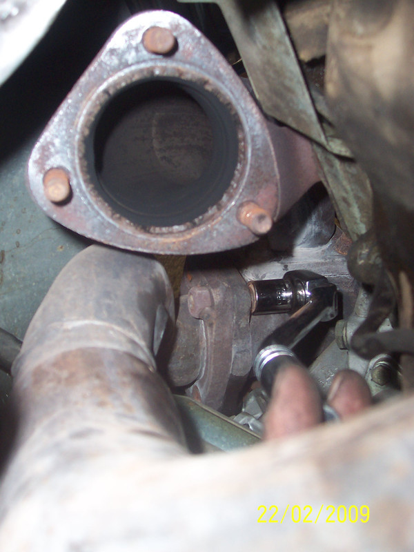

Down pipe has four bolts at the turbo (1) and two of them can not be removed with engine in place that I can see. I was able to remove 3 bolts (2) mid way down the downpipe so that section can stay attached to the turbo and engine assembly on removal, I assume.
The up-pipe on the right (3) however has 4 bolts/nuts 2 of which can not be accessed as far as I can see. Do I leave the up-pipe attached to the turbo/engine on removal?

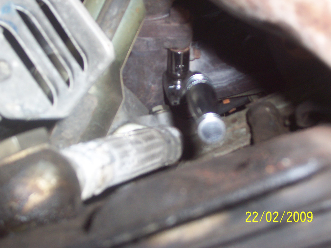

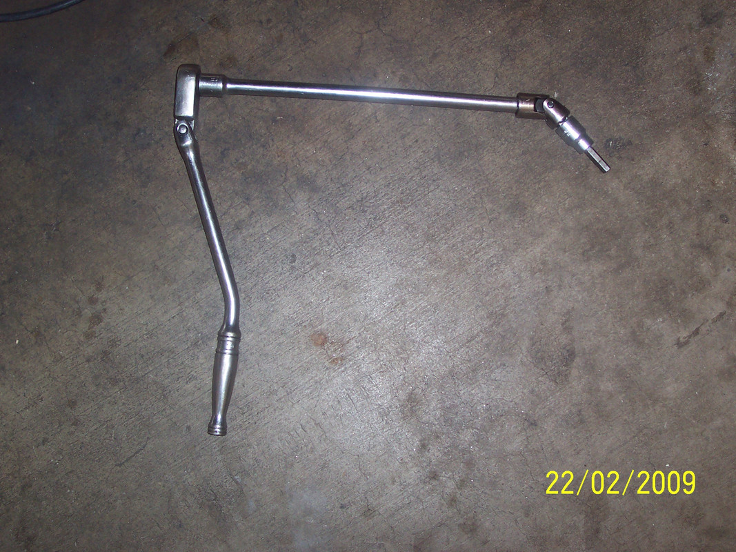

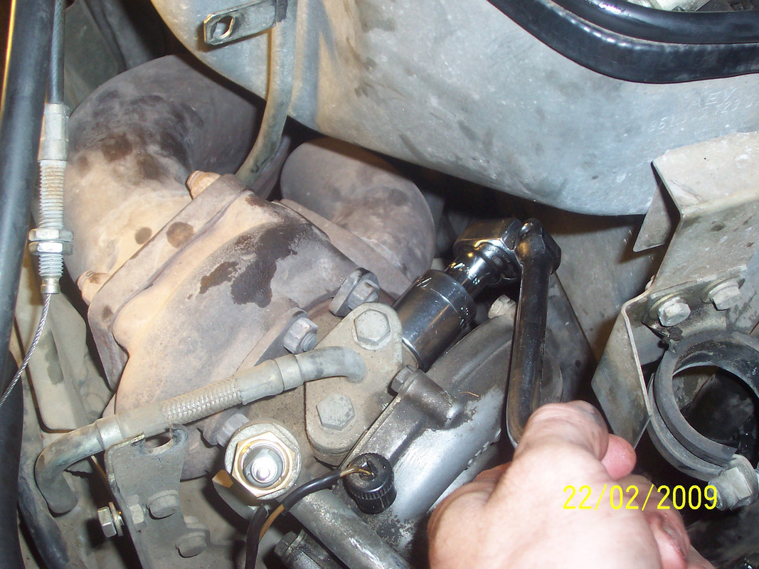

#3 are possible to remove with the engine in the car. Use swivels, universals and gear wrenches if needed. You will have to remove from the headers as well.

Yes the crossover pipe can stay if you are removing the engine from below.

Tools for removing the crossover pipe while in place:
