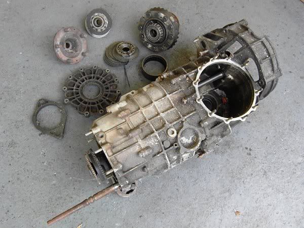

The first problem is the fact that the gearbox has sustained a damaged bell housing (whilst removed from the car). The input shaft is fine and turns without any problem, I have been offered a C4 gearbox casing, and wondered if anyone knows if the top half of the casings are interchangeable?
Any information would be greatly received.

As far as I can see the 964 G50 & G64 share the same bellhousing & diff housing. The G50/52 section is different
this part is a late 915 but it shows which section is shared on the various 964 trans

Bill - Thanks for the response and the picture.
I could not see any difference when I had a look, but always good to get confirmation (second opinion).

IIRC, when I broken the clutch fork boss off my belhousing, it was replaced with a C4 housing. So I believe that yes, they are all the same.

The box with bell housing damage also sustained damage to the input shaft, initially though it hadn't but on closer inspection runs out when spun. Does anyone know if the input shaft for the C2 box (G5003) is identical to that of the C4 (G64003)?
