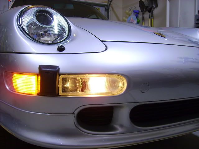

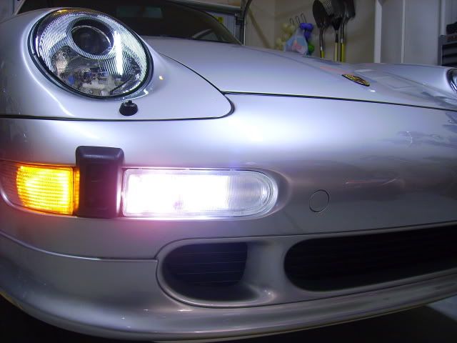

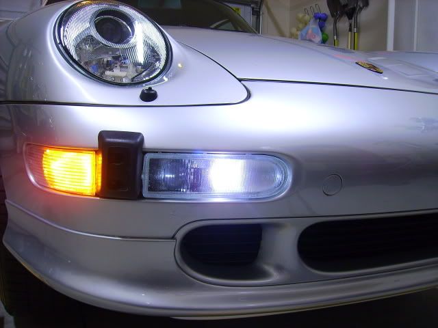

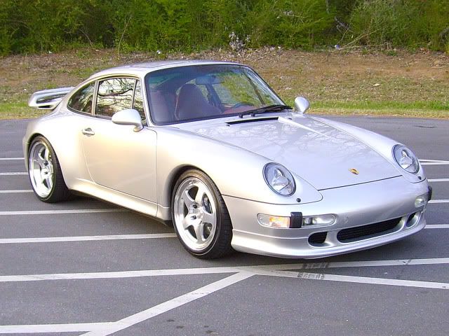

Finally found a proper LED replacement for the front running lights.
Before:
After:
New pedals:
Before:
After:

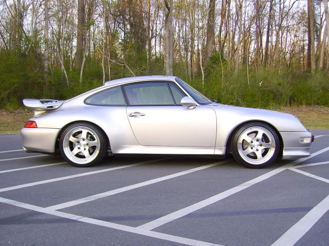

Rims...for the time being. Fikse Profil 5-18x8.5 & 18x11. Kind of boring, but strong and light. Will replace with Speedline Daytonas soon.

What LEDs do you use for the fog & front light?
Old 03-22-2011, 09:44 AM
"To be fair..."
Resident Sicko's Avatar
Join Date: Jul 2010
Location: Charlotte, SC & Oregon
Posts: 202
PIAA for fog, sent origonal running light bulbs to friend in Japan to match up.
(no affliliation)
I bought three different kinds (single/diffused/multiple diode and all work with same effects.

Scheduled a bit of time for Cat and I to take the car out after work yesterday...Still have some small things to address but all in all felt good, ran well and got a chance to make some ruckus. Cat drove it home and am pretty sure she likes it.
I have the Fikse rims and tires sold to a gentlemen in Colorado who just bought "Barney", a well known "one off" factory painted in purple. I have a lead on another set of Fikse mesh rims that I think will look more "proper" on the car to be used until I can find and afford the rims I really want then will become track rims.
The Fabspeed Supercup exhaust is quite loud.
Car still needs to be corner balanced as the front felt very "flighty", especially when accelerating and while 282hp in this car is not a huge number, it had no problem reaching 120 by accident on the freeway in between exits. Totally different type of car from the S2000. Softer, less "intimate" with not as much of a "grin factor"....but can be addressed with proper sway bars, control arm bushings and motor mounts I suspect.

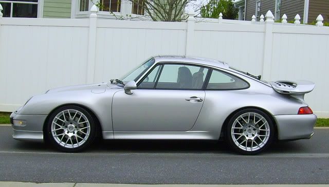

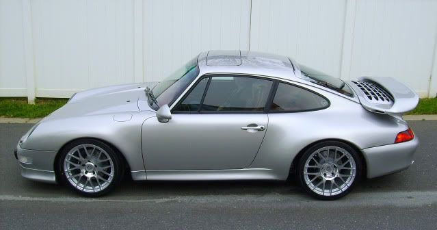

New shoes ans stiffer bars-
Forged and lifghtweight (19lbs for the 18x11 rears!) Innsbruck for the time being and future track use. H&R sway bars-26mm front and 24mm rear- Much thicker than the 20 and 17mm stock bars. In for powdercoating..

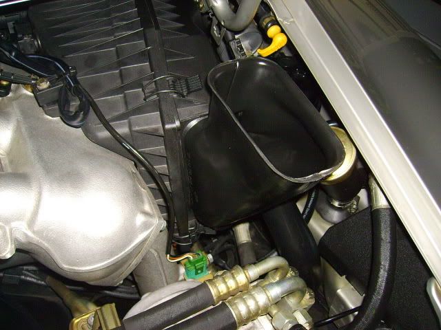

Genuine Porsche Cold Air intake trumpet from 993TT. (Hella expensive piece of blow molded plastic.)

Originally Posted by bruni911 View Post
Wow very nice
What are you doing with your old rims and tires?
Which ones? Stock? Sold and are currently on a super nice Silver turbo in California. (regret and looking for a replacement set)
Fikse? Sold currently on a kickass purple turbo in Colorado.
These? Will swap slicks on them and used for track. Will be replaced for street use with something a bit more heavy and a lot deeper dish in the back.
I'm curious about the wheel fitments, what are the offsets(ET) , what tires and what are the fender heights?
Bill Verburg
Old 07-07-2011, 06:37 AM
"To be fair..."
Join Date: Jul 2010
Posts: 202
Those were 18x8.5 and 18x11 both front and rear at +45 offset. Tires: 225 up front and 285 in the rear with a very low suspension setting. (was about 1/4" lower than RS) No rolling of fenders, no rubbing.
Currently am running more aggressive offset and 295 in rear but to me, the setup used with the Fikse rims was perfectly balanced. (front to rear fender overhang)
OK, Thanks. I forgot that you have an S. I see references to guys w/ n/b cars using 10.5 -11 and can't see how, so It just gets my curiosity going
