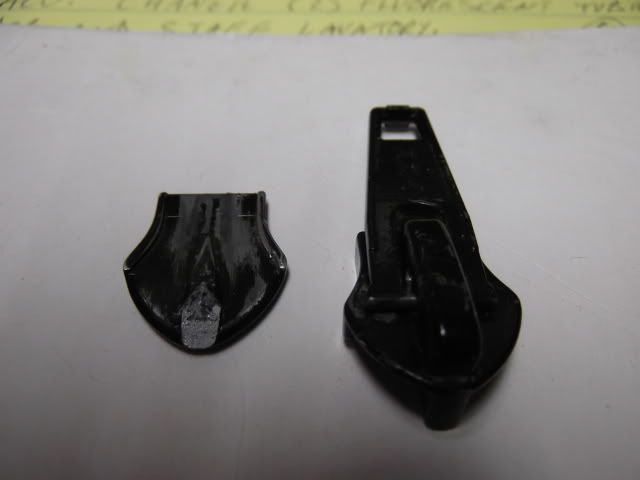

Needless to say, We had the top down both days! Today,After backing the Porsche down the driveway, I put the top up as usual but this time I had a terrible issue with the zipper on the rear plastic window. It had always been somewhat "sticky" when trying to zip it open or closed.
As I was trying to zip it closed , the "clasp" that draws the two zipper seams together broke apart. As it was getting dark, I threw a large tarp over the car and covered it as I usually do with two large car covers.
The top is relatively new ,only about 5 years old and the zipper looks to be in great condition. Here are a couple of pics of the broken part...
Anyone here been down this road before? I know that if I had a new "clasp", I would probably be able to get it "meshed" with the zipper again... is this part even available at all? ...Do I have any options?

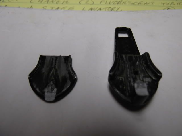

Well, after a day of deliberation, I decided to visit our local outdoor and sports
supply store in search of a zipper repair kit, thanks to "Google Search."
(This type of zipper is a heavy duty style and is used extensively in luggage, tents,
spa covers and...You guessed it ...convertible top rear windows and Jeep side and rear windows.)
Not only did I find what I needed, I had my choice of two and did not have to buy the whole repair kit...I was able to buy them separately...$3.75 each!
Looks like this...
Same manufacturer, Too. It was a YKK #10 C (Coil type zipper)
Hope this helps someone if this happens to them.
