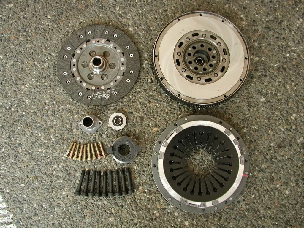

Thanks for the tip. Does the pressure plate really change between the SMF and DMF setups? Pelican's item number for the kit is PEL-FWC-C2C4N. The pressure plate included is part 964-116-028-090-M38. The PET lists this as the normal part number for 92- and an alternative part for -91 cars. Or I could be the victim of my own misunderstanding or a catalog error.
Old 02-03-2015, 01:37 PM
Moderator
Bill Verburg's Avatar
Join Date: Dec 2000
Posts: 26,517
Yes, the clutch used w/ the SMF has springs, the one for DMF doesn't
This is a SMF clutch disk from a 993RS/CS
This is a 996DMF setup 964/993 would be similar

I know that the single-mass flywheel requires a spring-dampened clutch disc while the dual-mass flywheel requires an undampened clutch disc. Can you help me understand the difference in the pressure plate?
Old 02-03-2015, 02:00 PM
Moderator
Join Date: Dec 2000
Posts: 26,517
You are correct the pressure plate itself is the same in both setups

It appears that you're just doing a top-end rebuild. How did you decide to do that? It seems to me like the top is the expensive half of the rebuild, so if you go that far it is not much more expensive or time-consuming to split the case. But I'm a complete novice and would really like to understand your thought process.
I'm trying to remain positive and conservative at the same time. It probably comes across as passive-aggressive: Just the clutch one day, total overhaul the next. But that's how it goes with a Porsche, it seems.
