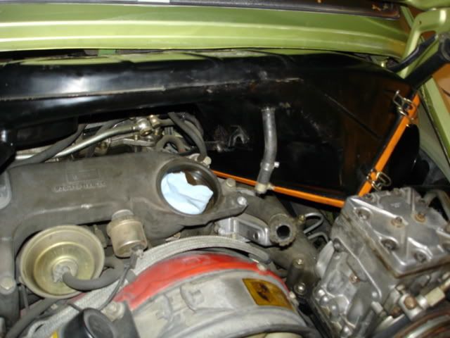

ok so far i have i/c off, a/c compressor loosen, all hoses disconnected, and i still can't get it out. what is the trick to this?

Push the left side back in and then pull the right side out and angle it up while doing so. There will be a hose on the back right side you'll have to disconnect when you get it partially out. That hose may be catching on something. The key is bringing the right side out first.

by right side yuo mean passenger side? this is really annoying..

Yes, the side toward the passenger side. Tilt the front of it it up and out then bring out the left (driver) side. You need to have the left side back in first.
