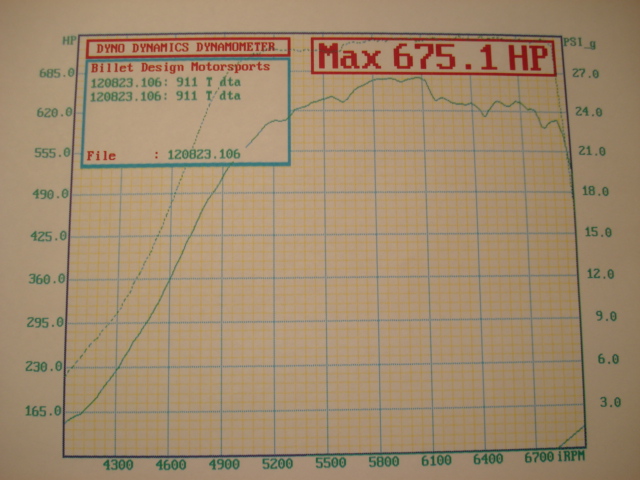

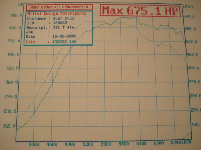

For Bragging rights
10.76@139-1/4 mile
0-1 mile 193MPH
