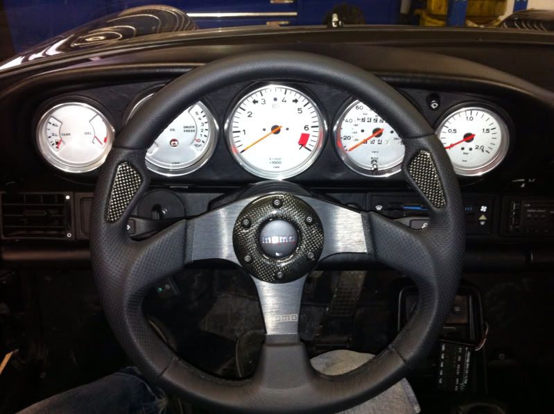

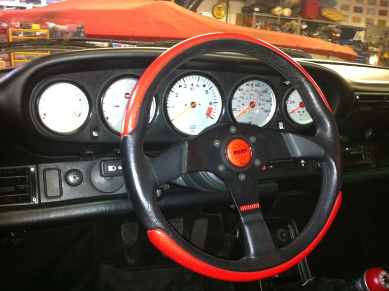

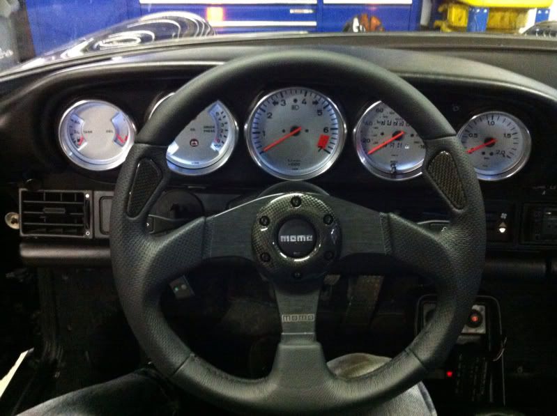

Fixed the sunroof, changed the steering wheel, finished the guage LED conversion, gauge bezels, cleaned up the engine bay some more, put the windshield back in. Seats ordered and when they come in, next weekend they'll go in along with the harness bar. Still have to order pedals and harnesses before interior is done. A couple of pics showing before and after, as well as with the lit LEDs (although in lit shop they don't show up very well). LEDs are a cool white, and wedge bulb for NHS boost gauge matched 100%.
