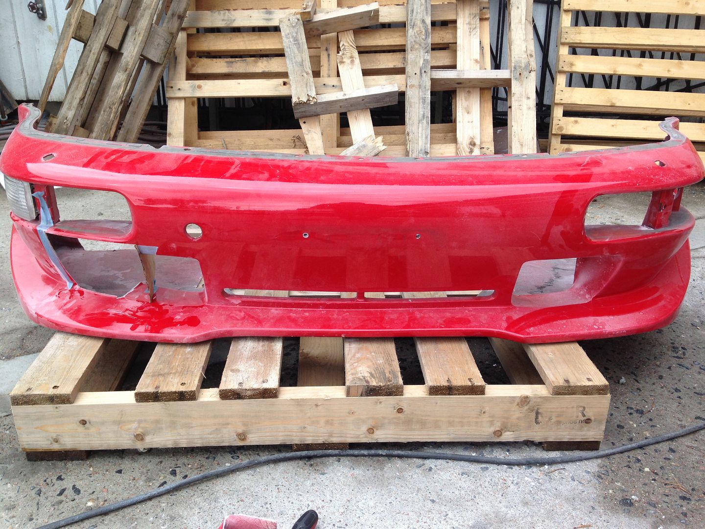

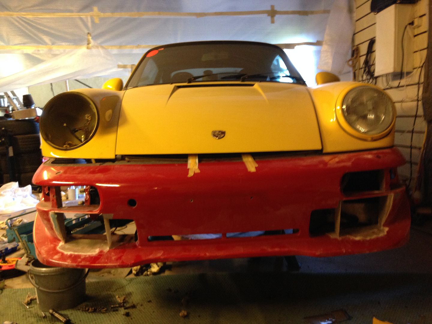

I have been struggeling to keep my engine cool enough on track events.
Before installing a front center mount oil cooler, I thought I could try move my 2 fender mounted coolers in better position, and also open up for more airflow.
I bought a used front fender, that also will provide more downforce, as a core.

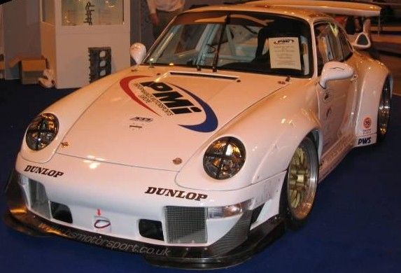

I have been inspired of the open ducting that the 993 GT2 evo front fender has.
This is my starting point

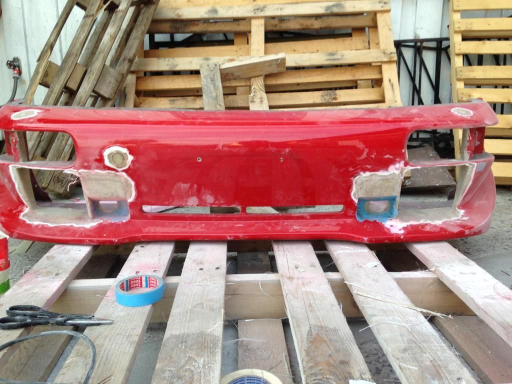

Then I started to cut out opening :-)
Then I started to section out the openings...

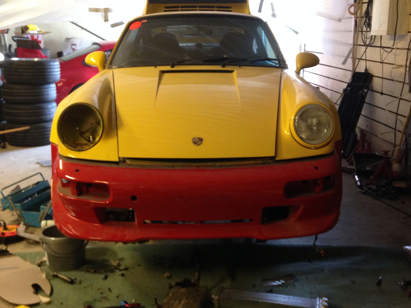

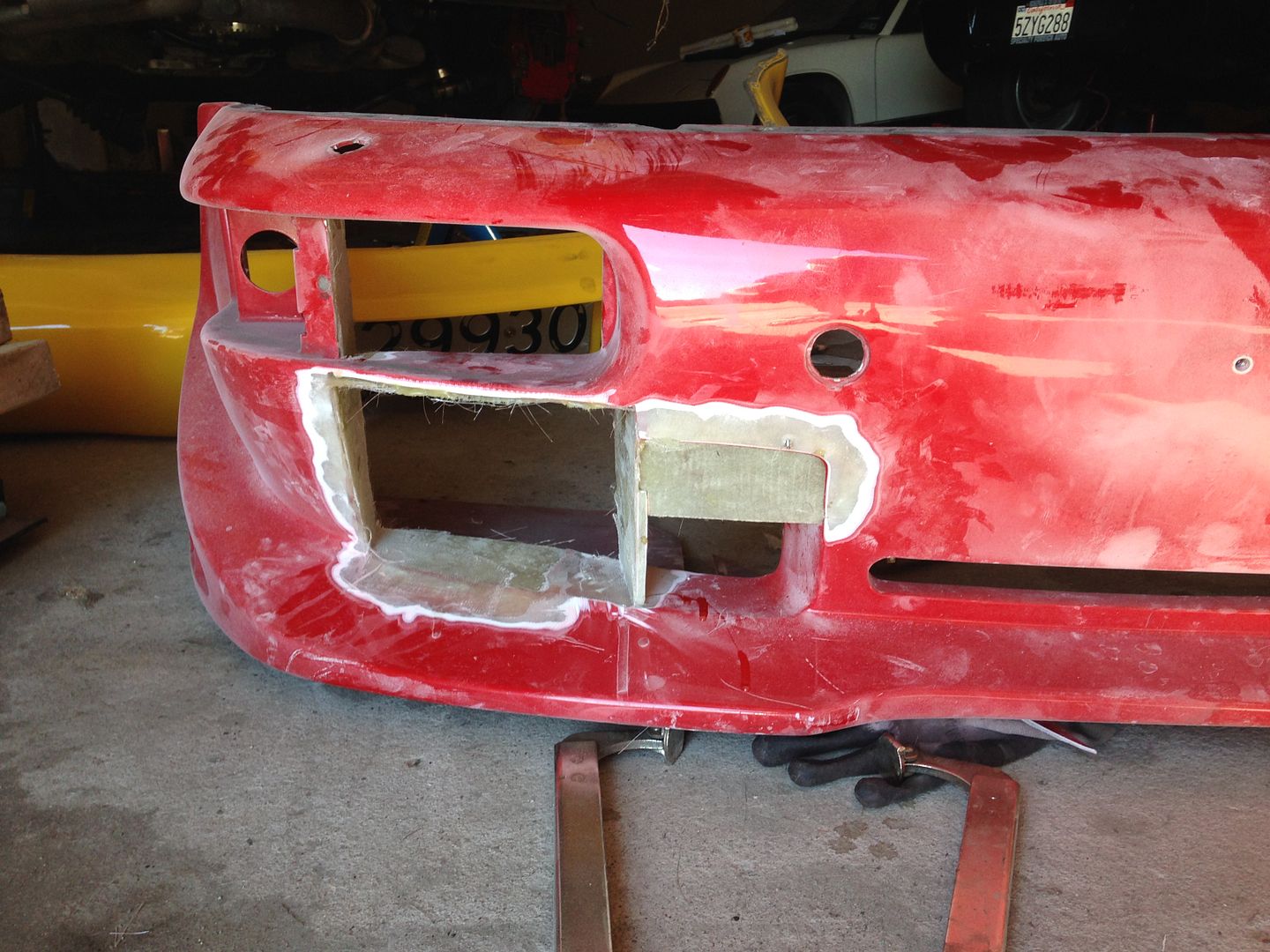

Then a little trial fit...
Trond R.
1979 930: Garret GT35r turbo, EFI, carerra intake, Link EMS, custom GT2 cams, 98mm JE P/C, 964 crank (stroker), custom valves & ported (XtremeCylinderHeads) etc..etc..
1972 914-6 GT replica project
1986 944 Turbo

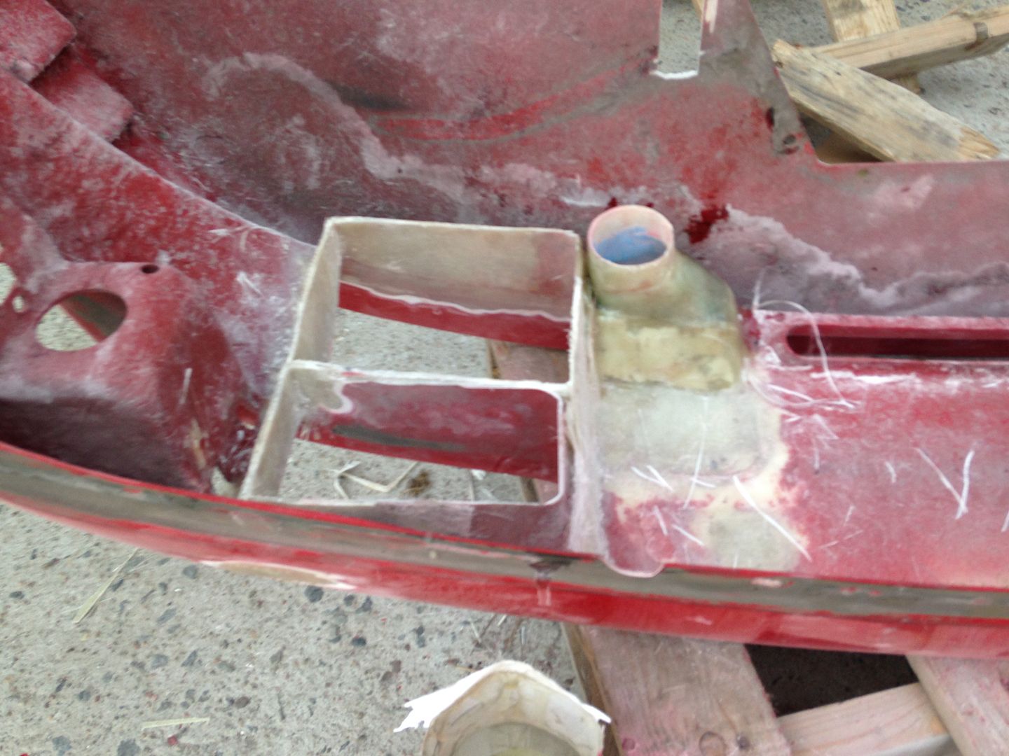

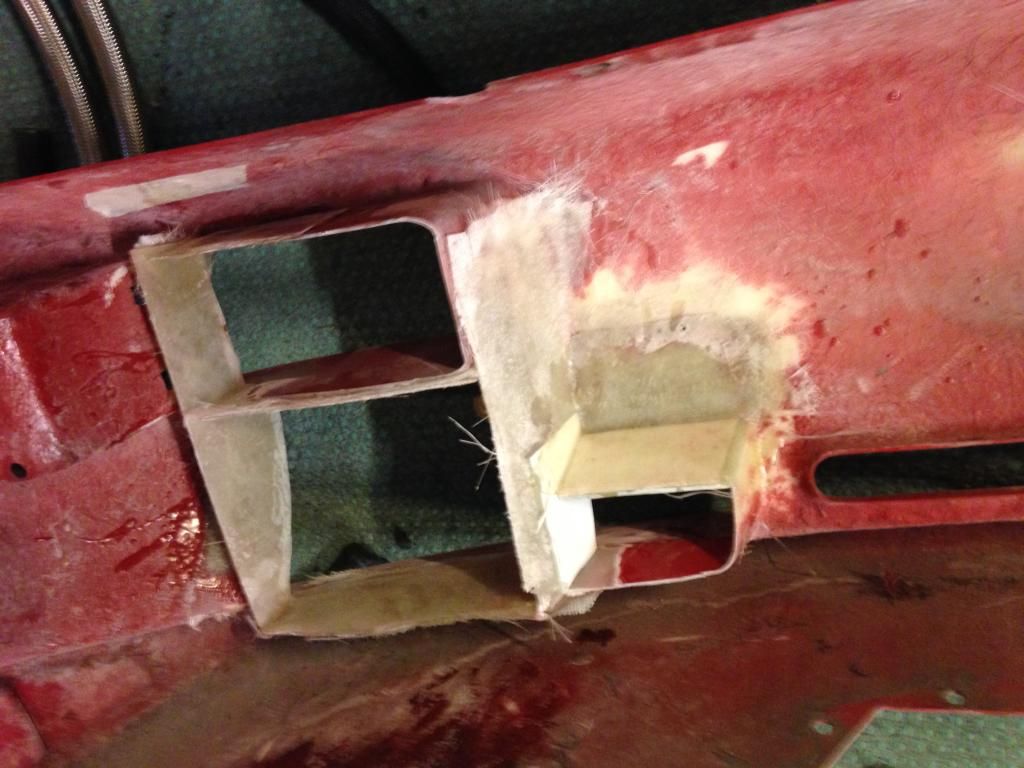

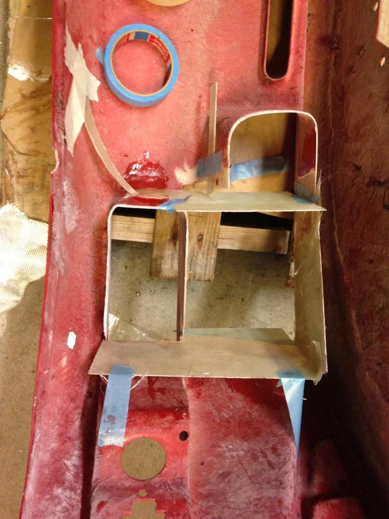

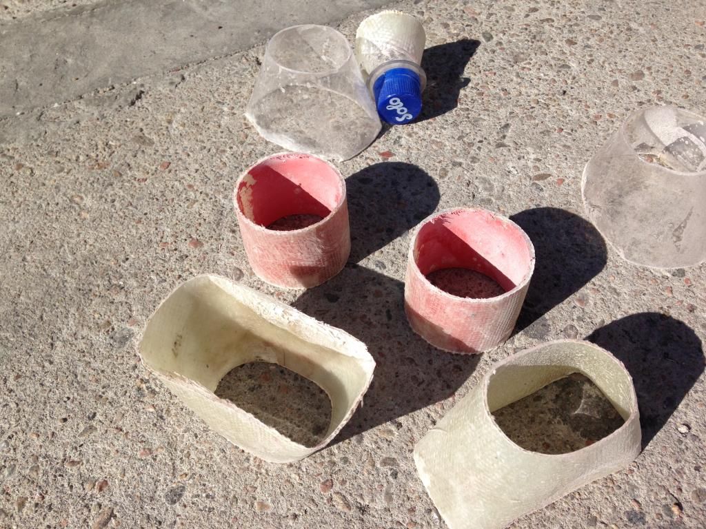

Design comes along as I go :-)
Found out that the small ducting could be used for cooling duct for the brakes.
Needed something square'ish to round tubes.
Used some plastic soda bottles, cut then in half and used the top section.
Stuck then on a 2/4, to create a mold.
An old rear shock, was used as a mold for the round tube :-)
Then some more cutting and trial fitting.
Brake air duct completed
Finally getting closer to where I want to be...
Trond R.

And you even used a norwegian Solo bottle.
Awesome effort! I like it.

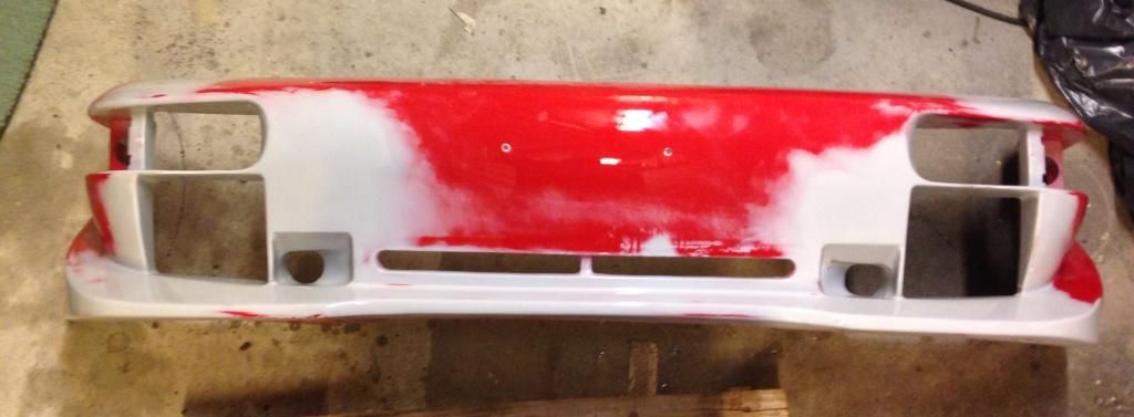

One more round of spray filler, and I think it will be ready for paint.

Nice work there Trond! I suppose you're too stubborn to go with center oil cooler as most others suggested?!? To be honest I'd be surprised if you still have overheating problems with your mod'd front bumper.
MikeD '87 930
Old 07-28-2014, 04:50 PM
totle's Avatar
Join Date: Oct 2008
Location: Norway / Miami
Posts: 1,390
Mike, it's not that I am stubborn, just like to try out new ideas
Yes, many has suggested front center monted cooler, many has also said ithe 2 I have should be enough.
If I'm failing, it will be a lesson learned and a hell of a lot work for nothing
But looking at the GT2 EVO, they did it without center mounted cooler.
I have also repositioned the coolers and cleaned them

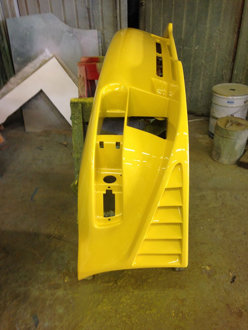

Painted. Tested out my new Eastwood HVLP paint gun
Will make some direct ducting on the oil coolers, then final installation :-)

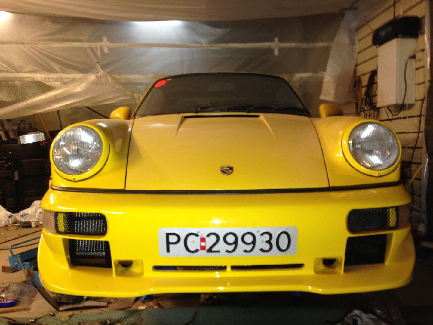

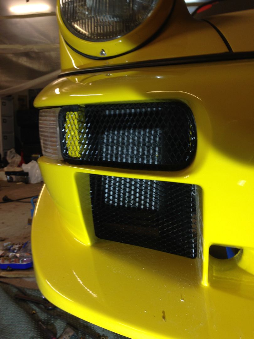

Now I think it will breath more :-)
