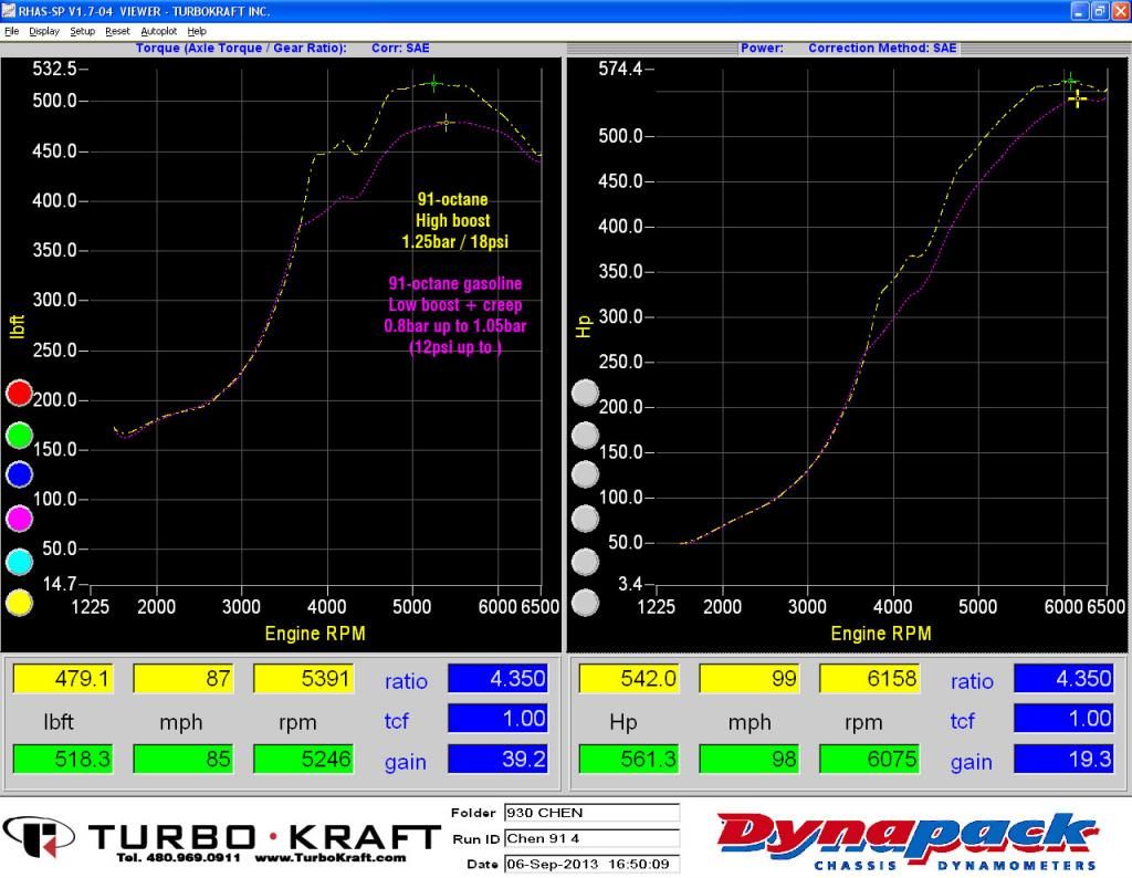

Here is my dyno, 3.3 piston GT3 crank Twin plug Single Garrett GT35 done by Turbokraft!!
It's fun to drive!!!
