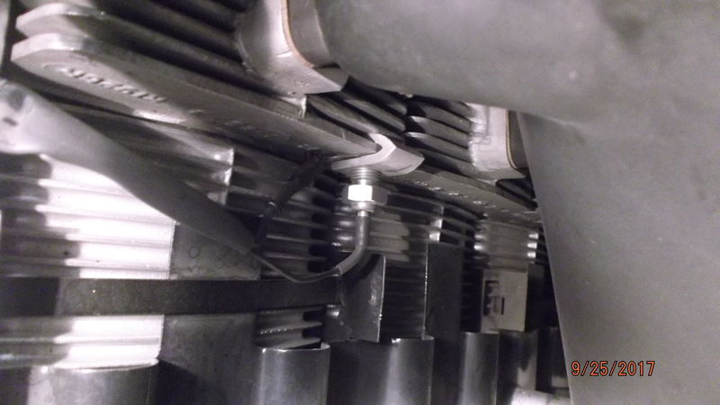

philip j 10-07-2017 03:36 PM
Hi Jim, about 118*. car stumbles if I bring it down before its warmed up, but when driving on cold mornings engine temp is only about 90*and intake air is 50-60*

John, on a cold morning, what is your engine temp when warmed up while driving? I have my CLT clamped to cooling fins on cylinder number 1. Even after I have warmed up the engine in my garage to about 130*, once on the road, it drops to about 90* bringing on fuel enrichment. I think I may move the CLT to the back of the engine by the oil pump as Chris Carol does... Philip

Philip, you might want to check your sensor calibration in boiling water and if its still between the fins. Hard to imagine cylinders dropping to 90F after they are warmed up unless the sensor is in direct airflow and not in between the fins.

I just changed my sensor, the new one gives the same readings as the one I took off...
http://forums.pelicanparts.com/uploa...1507562022.JPG

I still have to check the clt temp, I will do that this morning. My sensor is located on cylinder number 3 cooling fins. A hole was drilled and tapped, and sensor was threaded into hole. Your problem might be a function of the location.
jpnovak 10-09-2017 09:08 AM
There is too much airflow to clamp a "clt" sensor to that fin location. It will always show cooler than actual due to location and convection cooling.

Thanks John, this also seems like another good location... you didn't happen to get a pic if the installation?
