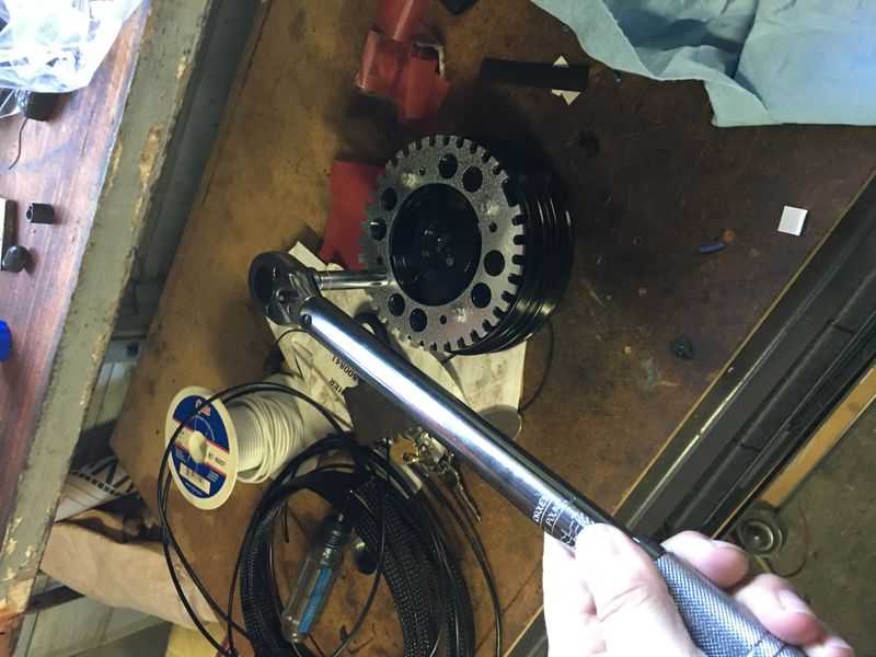

Question regarding signal wheel. I have a
36-1, should gap line up with Z1?

Picked up some 5mm hex bolts for reference wheel. What torque should I tighten them to?
Should I use medium thread locker?

dos531 05-30-2017 04:42 PM
Originally Posted by jpilcher (Post 9607061)
Hi guys
Yeah I did hex bolts on mine as well and used blue loctite. Location of the gap doesnt matter either, as it's set in the software. Makes it easier to know where it is for ease of setup though.
jpilcher 05-30-2017 05:15 PM
Thanks Derek.
jpilcher 06-01-2017 06:19 AM
Blue lock tite on 4 5mm bolts, torqued to 5 ft-lbs. http://forums.pelicanparts.com/uploa...1496323168.JPG
