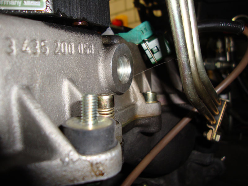

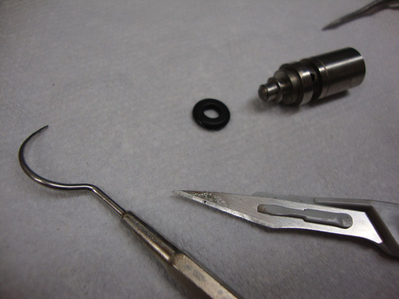

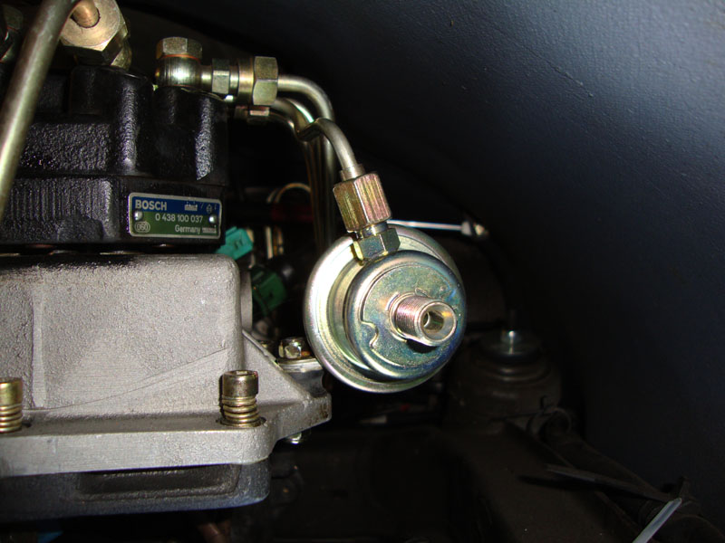

Installing New Fuel Pressure Regulator
Installing New Fuel Pressure Regulator:
The old Regulater had only 2 washers installed (0.8 mm) System pressure 6.0 Bar:
New:
New has 3 washers installed (1.4mm):

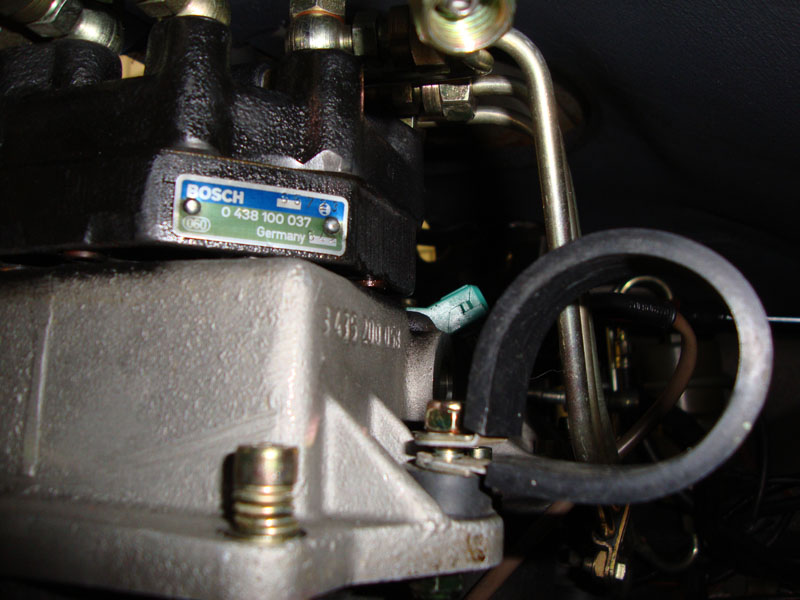

Check Fuel Pump Delivery Rate
First I Check the Fuel delivery Rate: Setpoint / min:1500cc / 30Sek. (both pump)
Actual Values: 1500cc after 22 Sek
Second Test: Delivery Rate from the Systempressure circuit: Setpoint 160-240cc/min
Actual Values: 280cc/min (98 oct) 461g-249g = 212g : 0.755 = 280cc

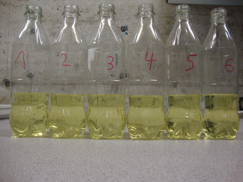

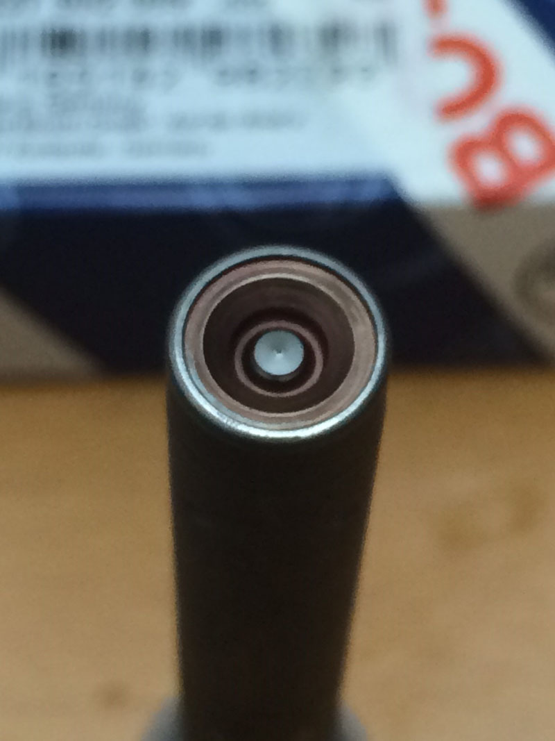

CIS Injector Testing
I did a injector test.
1. Injection flow pattern was ok
2. Spray 4 from 6 not similar (not atomizing correctly)
3. Drip or leak test ok
4. Delivery Rate ok 2.5% Difference
I have Order 6 New 009 Injectors, than i make the Test Again.

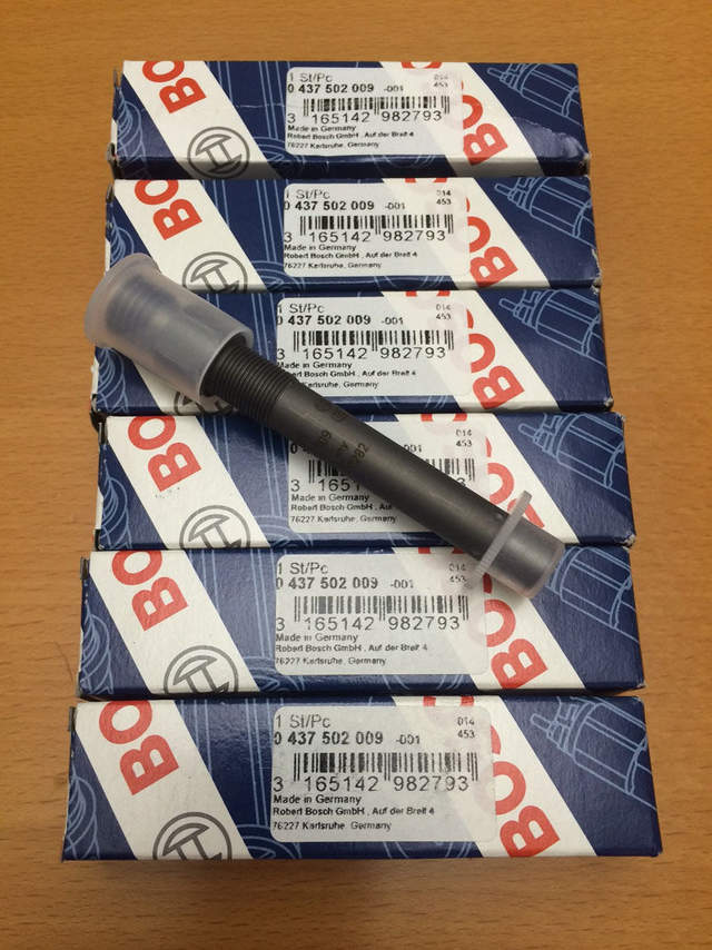

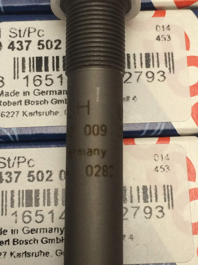

The Order arrived Today, 6 New 009 Injectors
Tomorrow they will be tested....

Second CIS Injector Test with New 009
I did a injector test again with the new injectors.
1. Injection flow pattern was perfect
2. Spray all 6 absolut similar (atomizing perfect)
4. Delivery Rate ok 2.035% Difference
Flow Rate with the old 009 Injectors vs new (Factor 0.755 98Okt)
Engine 930.66 / Fuel Head Nr. 0438100037 / WUR Nr. 0438140112 / Injectors Nr. 0437502009
System Pressure setpoints: 6.00 to 6.70 Bar (between 6.20 and 6.40Bar)
System Pressure actual values: 6.30 Bar (12.2V)
Contol Pressure cold setpoints: 1.20Bar (Temperatur 20°C)
Contol Pressure cold actual values: 1.20 Bar
Contol Pressure warm setpoints: 3.65 Bar (+/- 0.20 Bar)
Contol Pressure warm actual values: 3.20 Bar
Full throttle enrichment setpoints: 2.90 Bar (+/- 0.20 Bar)
Full throttle enrichment actual values 2.60 Bar
Delivery Rate in 30 seconds old Injectors (Full without Full enrichment):
Old: vs New:
Cylinder 1 176cc 184cc
Cylinder 2 177cc 179cc
Cylinder 3 180cc 179cc
Cylinder 4 179cc 176cc
Cylinder 5 184cc 180cc
Cylinder 6 182cc 184cc

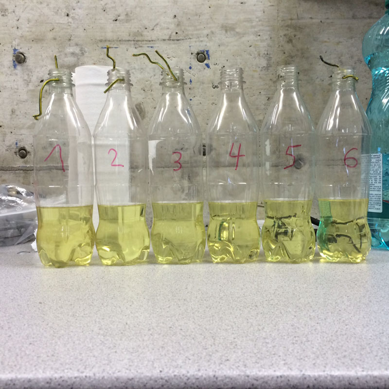

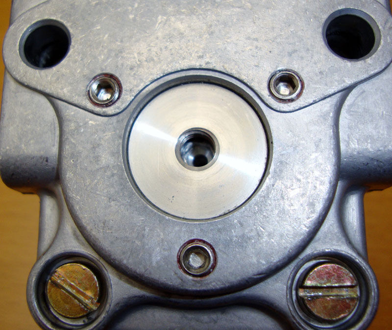

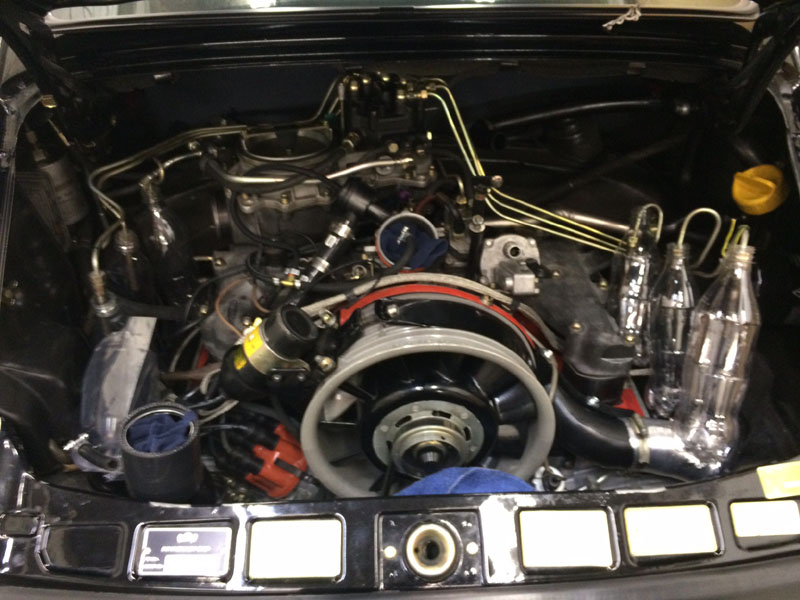

Adjusting individual Injector Flow on Fuel Distributor
Goal: Adjusting individual Injector Flow on Fuel Distributor
After my engine revision / conversion (1500 miles even driven) the engine outlet sees like this: Cyl. 2 and 5 looks similar leaner than 1/3/4/6
I removed the cap from the Fuel Distributor, under that cap is the adjustment screw for each cylinder (differential pressure adjustment / turning the allen head flow adjuster clockwise increases the Fuel):
I have the settings adjusted 5 times and that`s the new data:
Delivery Rate in 30 seconds new Injectors (Full without Full enrichment):
New: vs New (adjusted):
Cylinder 1 184cc 181cc (old 176cc)
Cylinder 2 179cc 187cc (old 177cc)
Cylinder 3 179cc 179cc (old 180cc)
Cylinder 4 176cc 178cc (old 179cc)
Cylinder 5 180cc 186cc (old 184cc)
Cylinder 6 184cc 183cc (old 182cc)

Thomas
So is this what you leave or just one first try and what's the desired goal?
Looks still a bit too much difference, 8cc or about 5%
Try once more little Padawan

This is at the moment my Final Adjusting the goal was more Fuel for Cyl. 2 and 5.
Cyl 2 and 5 are all the time leaner as the others than makes not sense to adjusting all Cyl to similar amount.
The Value for the other Cyl 1/3/4/6 has changed positiv with the new Injectors vs old (just cyl 4 has 1cc less than before but he was not to lean.
Cylinder 1 184cc 181cc (old 176cc) 5cc more as before
Cylinder 2 179cc 187cc (old 177cc) 10cc more as before
Cylinder 3 179cc 179cc (old 180cc) 1cc more as before
Cylinder 4 176cc 178cc (old 179cc) 1cc less as before
Cylinder 5 180cc 186cc (old 184cc) 2cc more as before
Cylinder 6 184cc 183cc (old 182cc) 1cc more as before

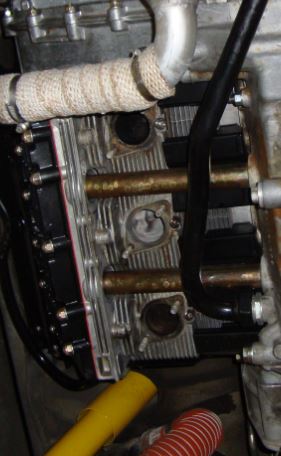

Roland here is a picture from the Header here you can see what i mean.
87 930 3.4, BW EFR 7670, TK Long Neck IC, Fabspeed Headers, 964 NW`s, Ported Heads, Tial F46 (0.4Bar Spring), Turbosmart EBC, BL WUR with rpm switch /solenoid, SDS CPI Ignition, modified Muffler, and many other little mods

So we can't wait to see how the headers/heads will look after a while of driving. I am curious how much difference it needs to get them equal in color/ AFR

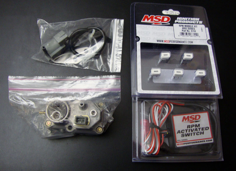

Brian Leask WUR and RPM CSV Kit
I`m happy now... I`m a proud owner from a Brian Leask WUR and RPM CSV Kit
Now, I just have to install the part...but first I have to fix a problem with my Cayenne S

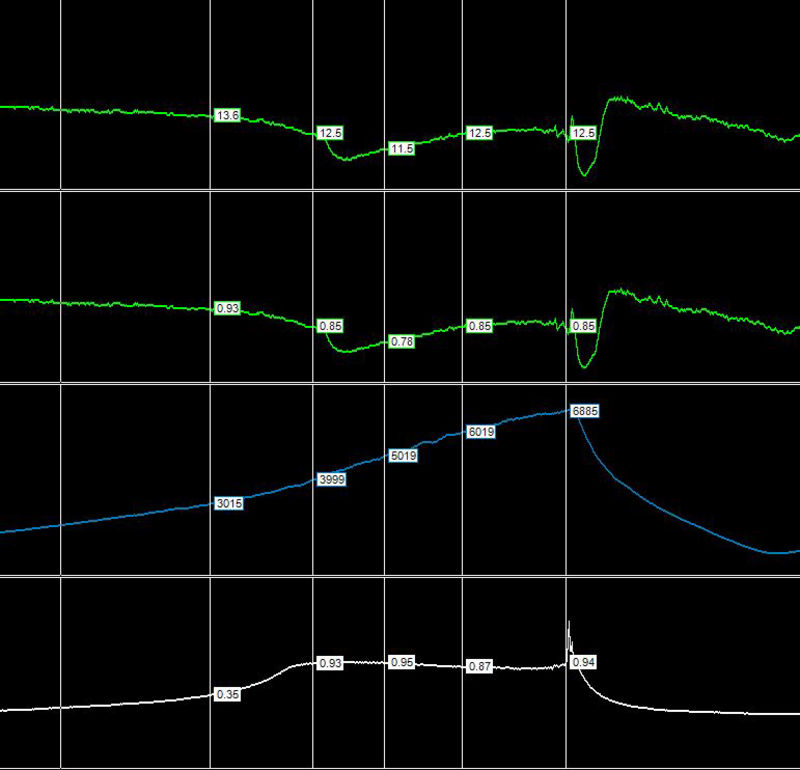

AFR Values with BLWUR
Much time has passed but now i have some results.
The AFR values are much better, i have just a little bit to optimize.
The picture shows the values of a dyno run:
