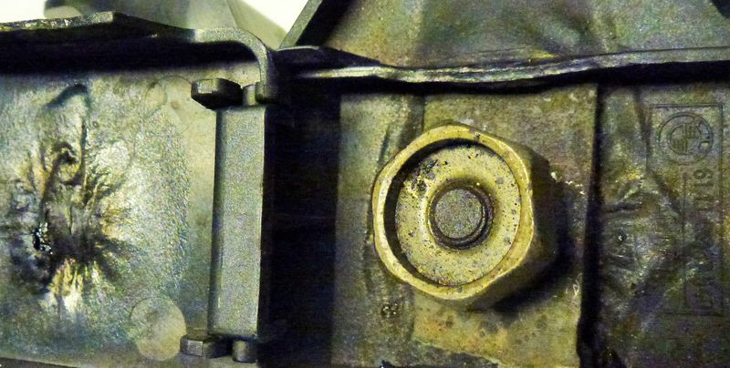

My 2001 330i displayed the battery light and my car would not start. I also noticed that the B+ jumper connection was getting very hot as evidenced by the melted cover and pieces of metal weld at the connection point. I replaced the B+ jumper connector and changed the battery but the instrument cluster does not work --> only the the check lights for airbag and ABS light up when I turn the ignition switch to ON or Ignition position. I checked the fuses (F10, F34, and F43) and has power passing through them. I also checked the Alternator output with load (headlights and AC) and it was 14.01 volts. Where could the problem be? I don't know how to proceed. Please advice, anyone?

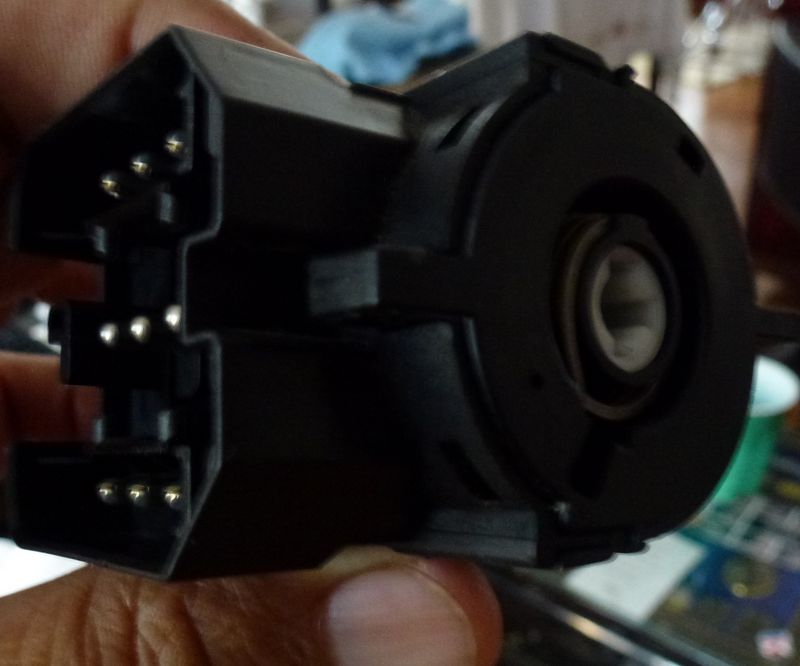

I went further to remove the ignition switch and checked for any obvious damage and checked for continuity. This was what I found:
Pin OFF ON IGN Pin OFF ON IGN Pin
1 X 5 8
2 X X 6 X 9
3 X 7 X 10
@ "ON" position contacts 2-6 are connected; @ "IGN" position contacts 2-6-9 are connected, 3-7-10 are connected, and 1-5 are connected.
After reassembly of ignition switch, I started car again but instrument cluster was still dead and I noticed that the radio did not power up anymore. Everything else works including the light that illuminates the instrument panel.
I re-checked the alternator output voltage with load and all fuses inside the globe box including the hidden high-amp fuses plus the fuses inside the eBox; all were passing voltages through them.
I ordered a new ignition switch (just in case); will install when received.

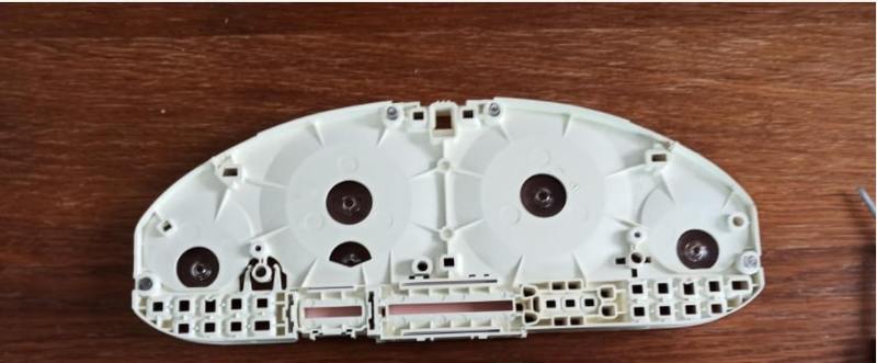

BMW E46 325ci cluster
Good day guys,
Can you please advise what this part in the instrument cluster is called for a BMW E46 325ci
