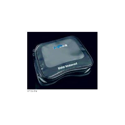

Does BMW make a tank bag for the HP2S?

Hmmm... interesting. Is it expandable? Anyone have a picture of it on a bike? I may not fit a DSLR in there, but I gots alternatives...

I have the factory tank bag. Bought it from Max BMW on Amazon. It is very small and not expandable. A thin jacket liner is all that will fit there. Not worth it in my opinion.
You can fit a standard garmin car GPS in the clear window, so if you want to use it a a cheap GPS mount solution, then it's ok.
BMW HP2 TANKBAG : Amazon.com : Automotive

Steve, go with the tank ring mount solution. It's much more functional plus you can buy expandable bags that fit your need. Forget the OEM bag.

Well, here's my thoughts.
- I don't need to carry much, and I'm not picturing this a long-range bike. I have small cameras.
- I used to put my radar detector under the map window of my other bags; like that setup because I can take the detector off the bike with the bag.
- it sits in front of the gas cap, so no hassle there.
- it's cheap, so I could always do something else.
