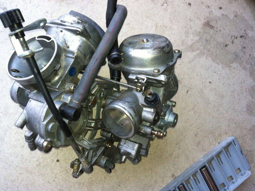

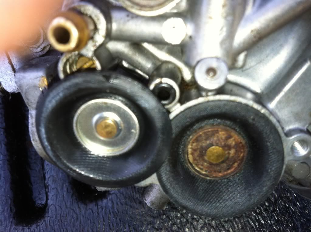

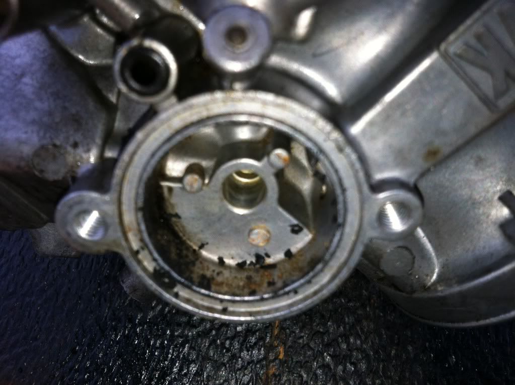

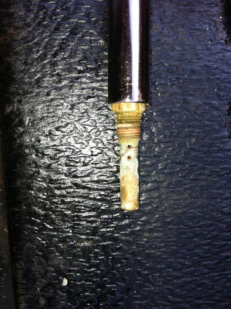

Originally Posted by Dr. Curve View Post
One danger with bikes stored for a long time is that the injectors get corrosion on their tips and not only can refuse to squirt a suggested mist pattern.........but they can stick open as well. Take the injectors out.......this is very easy........and test them directly. If nothing is coming out.......THEN......go for the other stuff like lines, connects, and the rest. Just my opinion......I have seen this very problem before.
Jim, that goes for carb bikes also. I just got finished bringing a friends Kawa 750 Vulcan back to life after it was left sitting for three years. Heres what some of the components looked like. Thanks again to Bill Swartzwelder for some tips.
