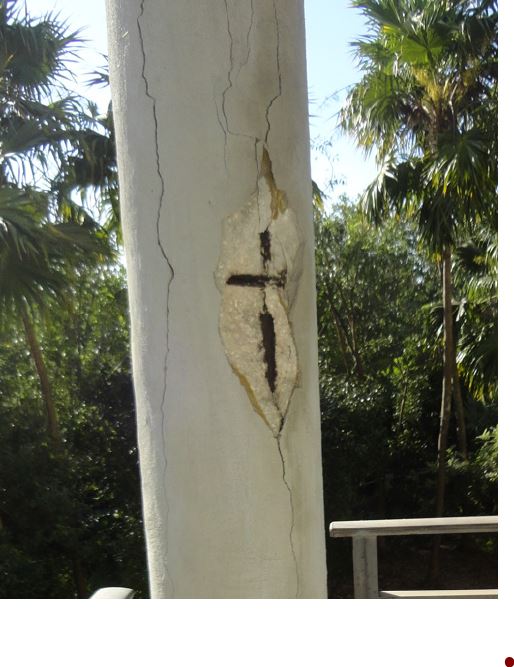

Found some pics from the engineer's report for our association similar size building, 160 units, 4 stories plus underground parking. Per my prior posts, we had members and directors fight these repairs for nearly 10 years:
These are post-tension cable failures:
I don't have pics of the garage columns, but they were at least as bad as the exterior columns.
Glad I'm out, it's been 8ish years since the renovations were done, I suspect the local officials have this building on their radar again.
