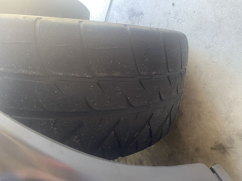

Thoughts on swapping these tires inside for outs.
In order to get another weekend out of my tires, do you think I can swap them inside for outs?
It may not be optimal, but at $800 a set of four plus mounting, it’ll stretch these out one more time or two. I’ve already rotated them, putting my best tires on the left side for the last event.
Edit. Since these are discontinued, I will have to find something else.

Looks there is a distinct outside and inside. definitely not optimal .

I suspect you either drive at 9/10 all the time or you have an alignment issue.
Get the alignment check and...
If you can, dial in a bit more negative camber.

I’ve flipped worse…
You really need to try out Hankook Ventus RS4s next…

Timed event or DE?
DE? Flip them. Watch for the edge chunking, especially if it's hot and sunny.
Actually if it''s really hot and the track is greasy, I'd leave them the way they are. Retire them when the cords start showing.

Originally Posted by doug_porsche View Post
Hmmm,
It’s mainly a track car, but I do drive on the street sometimes. The car has been aligned and corner weighted. If I recall correctly, I now have -3° camber. I have adjustable camber plates, but I don’t know if I get can get any more negative camber. I’ll give it a try.
Originally Posted by rockfan4 View Post
Timed event or DE?
DE. They came with really shallow tread to begin with (8/32), so I don’t think chunking is going to be a problem.
What I don’t want, is to drive to the track, drive that weekend, with the potential for cording them, cutting my weekend short.
I have not seen or read anything about them being directional, so I think I’ll be OK.
Edit: a couple weekends ago, I got my fastest lap times with them. Third DE with them.
