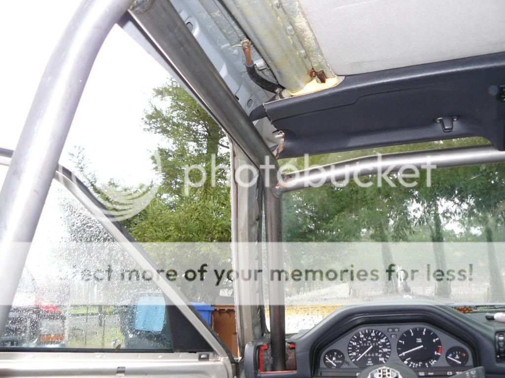

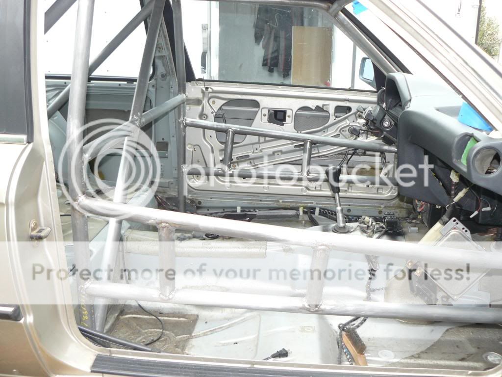

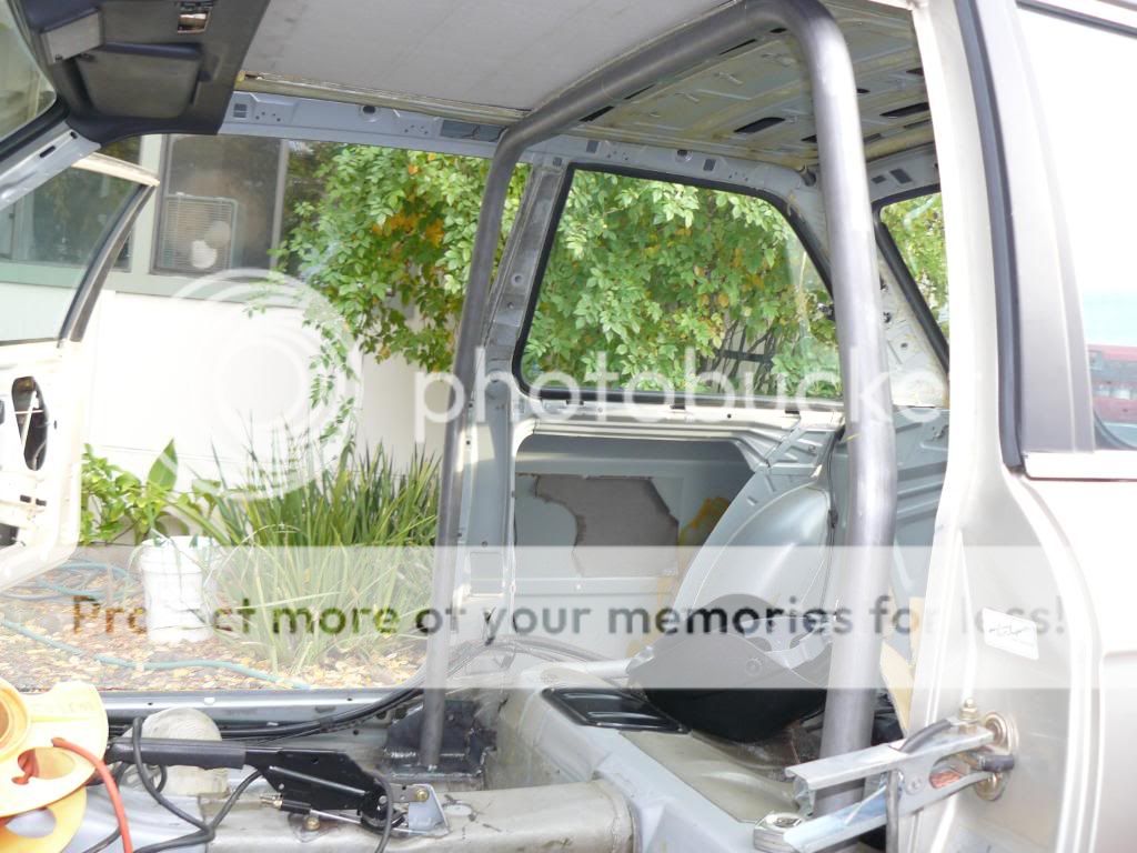

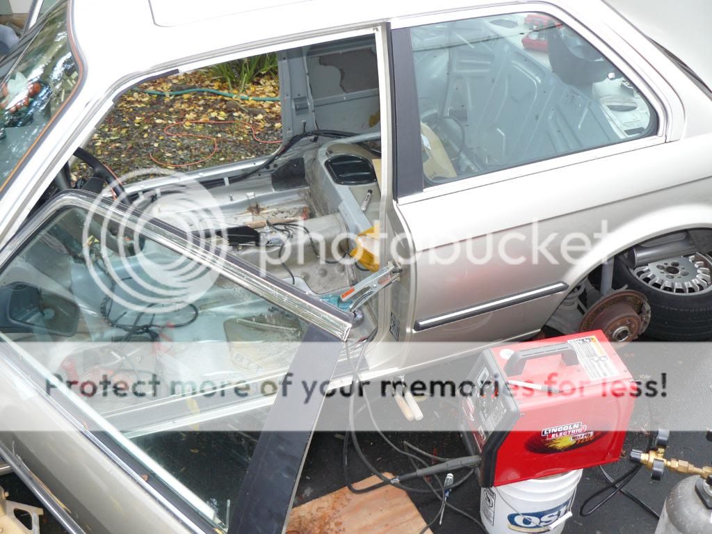

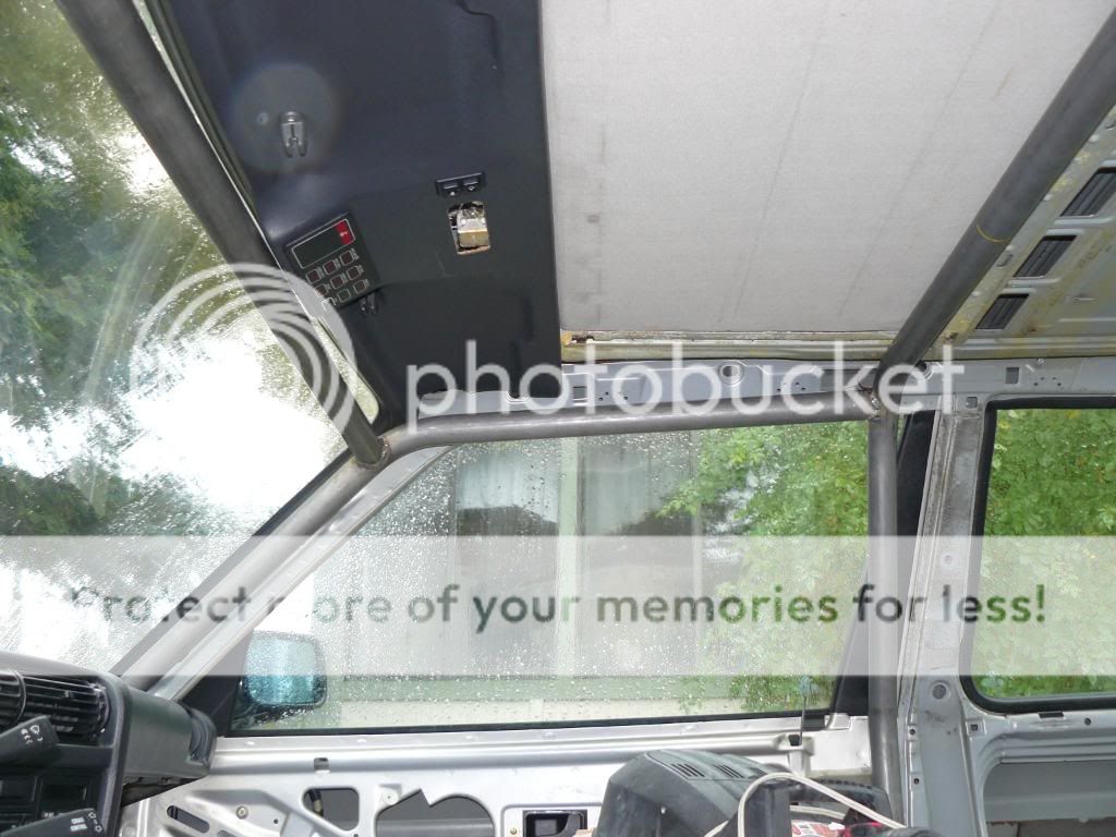

I haven't been able to spend as much time on the car as I would have liked to for a variety of mostly uninteresting reasons...
Anyway, I have a total of 23 hours in the build so far, including the compression test.
The roll cage is about 70% done, time wise.
Rear hoop, front down bars and windshield bar are fully installed.
I wanted to spend all day today finishing up the cage, but it's going to be stormy.
All the brake parts arrived yesterday in the mail from Porterfield.
Looks like the new seats won't be delivered for a week or so.
Nice thing is, there are no track days for the owner to go to right now.
No pressure for me to finish.
I estimated 40 hours in the build. So far I think I am on pace.
Here's a few pictures I just snapped between rain drops~

Are you bending the cage or was it pre-bent? How are you getting the welds around the entire circumfrence?
Old 12-25-2010, 02:38 PM
JW Apostate
trekkor's Avatar
Join Date: May 2004
Location: Napa, Ca
Posts: 14,164
It's a pre-bent kit from a local race shop.
All the pieces are a little long for final fitment options.
I have left enough room to do 360 degree welds on all joints.
I hope the project turns out really nice and the car owner sends more clients my way.
I would love to build one race car per month.

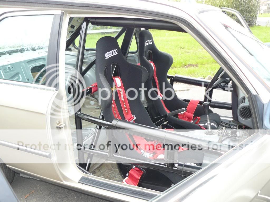

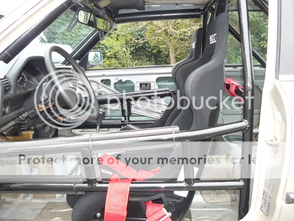

Back from a little vacation and back into the project.
test fitted the seats and the roll cage is just about done.

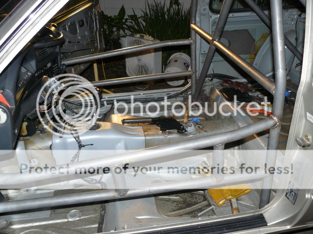

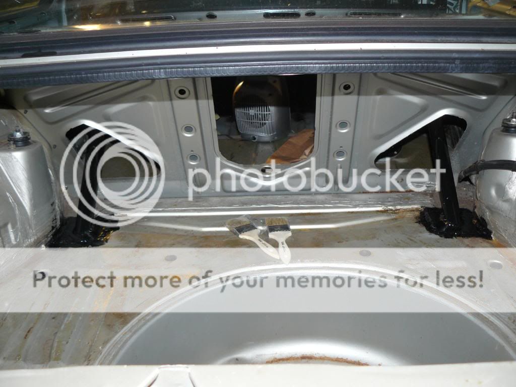

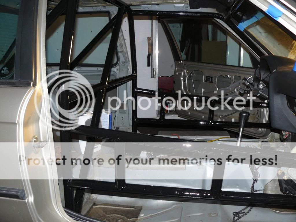

Cage is done and painted!
