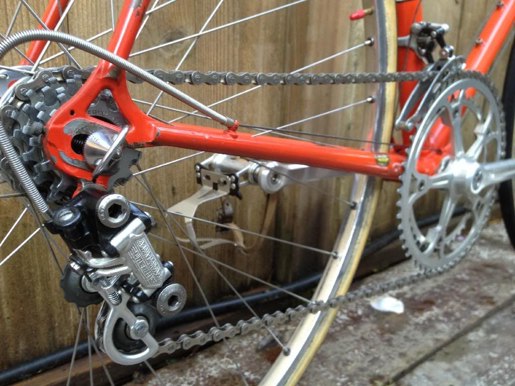

I rolled my Gitane Pro out into the daylight for the first time yesterday. Still need brakes, stem, bars, but should be complete in a few weeks. Haven't mounted the new tires yet. Anybody got a Cinelli 1R 100mm in NOS-VGC condition for sale? ![]() Need 1R like this:

It is ready now. I need to install some clipless pedals. The tires are old, but hold air and look pretty unused, so I'll chance them for awhile.
Geez, that Gitane is perfect. Oozes race heritage. Are you going to ride it, not or little or more?
More Team Pro geek factor here.
With pedals it weighs 8.99 kg or 19.82 lb. My goal is to get it to 19.0 lb. Looks like that could be done with a lighter (230 g) vintage saddle, very light (200 g/each) tubular tires, hollow pin chain (250 g) and light clipless pedals (230 g/pair). Now, here is something interesting. With an alloy freewheel, lighter bar (like a 3ttt Superleggera), some titanium bolts (quill stem, chainring, seat binder) and nuts (crank), double butted spokes and alloy nipples, I think - not 100% sure - I could get the bike to 18.0 lb. Admittedly that is nothing special by modern carbon bike standards, but for a vintage steel bike with all vintage parts including full Super Record group, that's pretty light. Hmm - tempting. Last edited by jyl; 04-18-2014 at 06:48 PM.. |
I think I am going to rebuild the wheels. I can't get these round, true, with even and high enough tension. I've worked on them for three evenings now. Enough.
I can lose a couple ounces off the spokes and nipples in the process. |

I'll post a couple more pics of my bike. I lucked out. The components are all top drawer from back the day. Everything that can be, is Super Record, except the PO changed to Simplex retrofriction shifters. The bottom bracket has the hollow Ti spindle, the pedals have Ti spindles, he got alloy bolts and barrel nuts for the seatpost. The saddle is a Brooks Swift with Ti rails. The rims are Fiamme Yellow. The stem and bars are Cinelli. I'm going to keep the rims and Campagnolo high flange hubs but rebuild with double butted spokes. Looking for a lighter saddle; I like Brooks but my butt is not too fussy, and I can use this one on a different bike that isn't a weight weenie project. I need to find a different freewheel, the gearing is currently 53/42 x 12-17 straight block which is too manly for me. A 14-22 or 14-23 will do me fine. I've fitted a Regina Superleggera hollow pin chain and that cost $1/ gram saved, ouch. I'm also eyeing some 3ttt Superleggera bars and a lighter stem, to shave a bit more weight. |

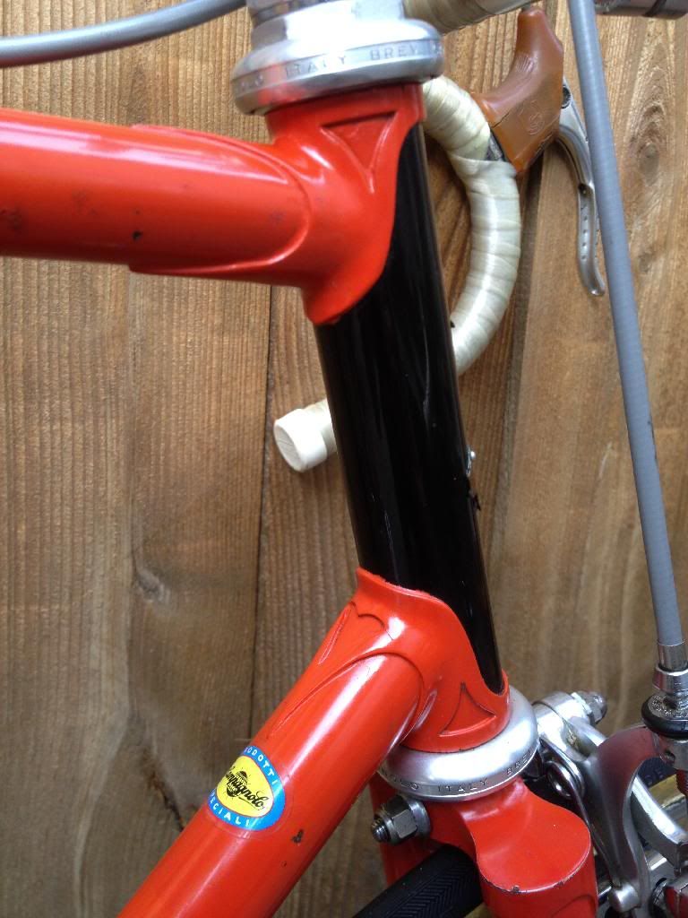

That is really outstanding John!! Must be a really early version (maybe even late 70's???). Older version SR derailleur. Doesn't have recessed brake caliper mounting bolts. 1A stem. Is it 531 Competition or 753?
The hi-flange hubs are interesting but after thinking about it, they were the hub of choice for racers up until probably the late 70's. The theory being that the shorter spokes resulted in a stiffer wheel. And an Easter present from the Pope ![]()
