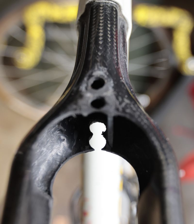

Nuts. I am always afraid it will comprise the integrity of the carbon rear triangle especially on the brake bridge. I'm interested in the long term reliability. Let us know.
Ha! Whaat??? This brake bridge isn't stable?
I'm planning on a two part process - One, insert a straw over the a dummy brake bolt which will preserve the brake hole, and pack the internals with CF. This will effectively give a new solid brake mount. After that cures, I reshape, and wrap the whole thing from the outside with good compression to give some real strength. sand and clear coat.
I planned on mixing CF today, but the epoxy is out in the garage and too cold to use.

In tonight's news, part one of the Fondriest splice is done. I have rebuilt the brake holes. Solid as a rock. This weekend, I wrap the outside of the seatubes for good luck.

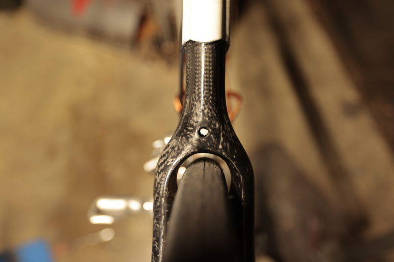

Just unwrapped the carbon fiber project. Turned out great (well.. for my needs) . I'll hit it with some fine sanding/clear/ and call er' done!

Thanks. I wasn't able to get the weave perfectly oriented around the complex shape, but it's so overfilled it will never crack. I was more concentrating on getting the fiber compressed. Stuff is a lot harder to work with than fiberglass. A biat$$H really. This is a bike I use on a trainer, which puts a lot of stress on the seatstays.

Still, looks like you did a great job on the repairs.
