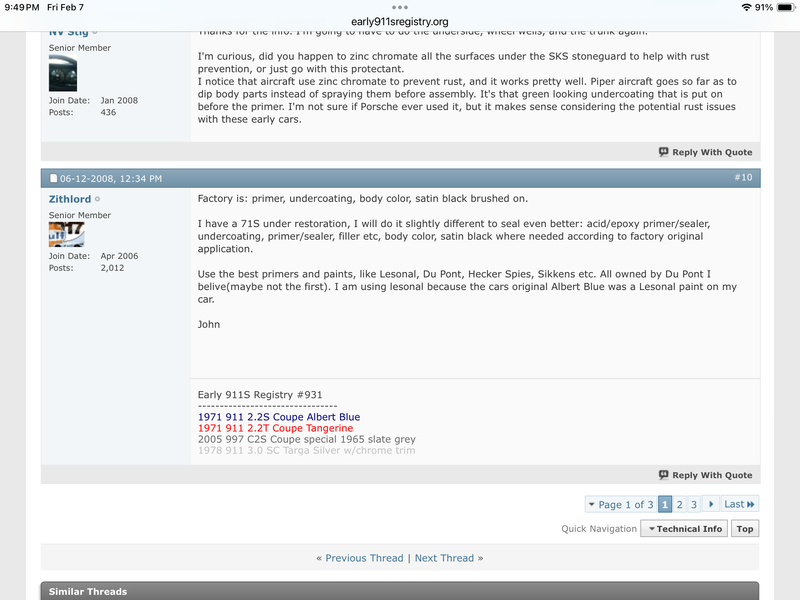

All my research (including on this forum) has said that it would have come out of the factory with black undercoating. Do you disagree?

Just did a search
You are correct……see 2 photos from early S registry
73 ( my reference was body color) earlier painted over black
