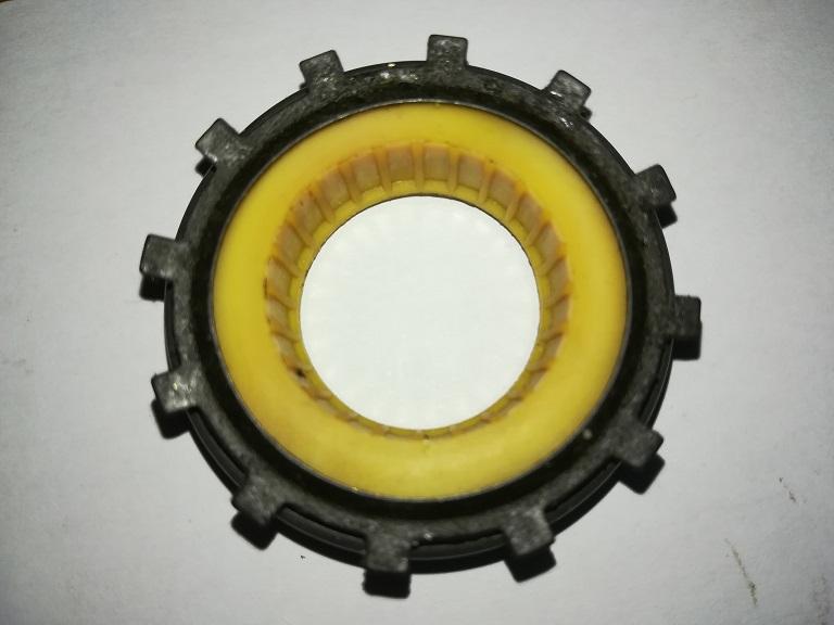

Good day, my 911 (112k) steering wheel has developed an up and down play, all the time. From my research I believe it to be the steering column upper bearing. I have never taken the horn pad off. It does feel loose just to pry all three pad points straight up, but am a little concerned on breakage. Questions:
1) Does anyone have a part number of the bushing? I see several on PP, but am not sure.
2) Any tricks to pulling off the horn pad?
Thanks in advance for any help.
Dave

Give us a call at 888-280-7799 and one of our Porsche reps will be able to assist you with the proper part number.
Could it also be the bushing that broke? Based on our tech article, the bushing can cause a lot of play in the wheel as well. Link below.
https://www.pelicanparts.com/techarticles/911_Steering-bushing/911_steering_bushing.htm

Mitch Leland to the rescue.
http://forums.pelicanparts.com/porsche-911-technical-forum/480462-mitch-lelands-steering-wheel-bushing.html
Be sure to give this thread a read before deciding.
Great replacement for the OEM bushing and lasts a lifetime.
I believe you can pull off the hornpad. (Gently)

You can buy a Mitch Leland unit but the regular cheaper part from pelican works just fine for me. There is no weird noise and tightens everything up. Also, once it is in place you will never see it again.

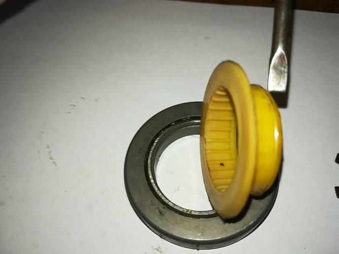

get yourself a new bearing from Pelican ..remove the teflon spacer.I always trim the bottom lip so it is easier to push onto the shaft.Then install the sunshine clip which will hold it nicely in place and c clip.It will last you for another 20 years...

I need to do this also but when you click on the link provided, from Wayne's book, in pic #2 it shows a slotted metal bushing, yet when you click on the "click here to order" it shows a completely different part. And if you go to the parts section I can't find the slotted metal bushing anywhere. Yet, by coincidence I guess, I got an email from FCP Euro showing the exact part shown in Waynes book. I would rather support Pelican, but I just can't find the part. https://www.*******.com/products/porsche-steering-column-bearing-ina-92834773902

Good Day, I ended up with the Rennlist part i69, due to shipment time and pricing. Not sure of what the two set screws are for. Do I simply just tighten them down on install?

IIRC those two screws can be used to pull (push?) the bushing out should you need to replace it ever.
