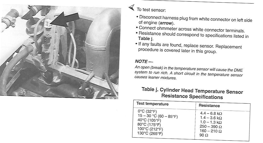

Verify my CHT sensor test results
My 3.2 has always had a kind of rough idle when it is first started. It starts out strong, but as it begins to settle down towards the 880 rpm speed it starts to hesitate a bit. It isn't hunting around wildly and hasn't fully stalled, but sometimes seems it is about to before suddenly correcting. Once it has been running for 5-10 minutes the problem goes away.
The distributor cap, rotor, plugs, and wires were replaced 18k miles/7 years ago. I just cleaned the IAC valve, it was pretty clean to start with and didn't change anything. So next I measured the CHT impedance. I got the following results:
4.3K ohms when engine was dead cold, 21C outdoor temperature.
160 ohms after the engine had run for 5 minutes or so.
Based on the chart in the Bentley manual, it looks like the cold reading is too high (indicating colder than it should) but the warm reading is in spec. Seems like this would explain why it starts off rough and then gets better. I have a replacement sensor, and it measures 2.18K in ambient air.
I was hoping someone with experience can check my work and confirm before I go to the effort of replacing the sensor, because I know from experience doing the speed and reference sensors that it's going to be a pain in the neck.

here is a little help for you

Bosch NTC sensor is nominally 2.5 KOhms @ 20C, +/- 5%.
4.3 KOhms @ 21C is a very long way from 5%.
Bosch datasheet says:
Characteristic Application
T [°C]R [Ohm]
-4045,313
-3026,114
-2015,462
-109,397
05,896
103,792
202,500
301,707
401,175
50834
60596
70436
80323
90243
100187
110144
120113
13089
Here: Temperature Sensor NTCÂ M12

Oh, the data sheet info is great, I didn't even think to look for one! Thanks. I'll definitely be replacing it. I hope it helps with the cold idle issue.
Old 02-11-2020, 11:57 PM
autojack's Avatar
Join Date: Jan 2012
Location: Melbourne, Australia
Posts: 377
Just to follow up on this: I did replace the CHT sensor and it fixed the idle issue. No hesitation anymore when it's cold, just nice steady running.

Problems associated with a temp sensor are simple:
1. Temp sensor resistance indicating greater than 5,000 ohms when warm, results in black smoke when the engine is warm.
Use a paperclip to bypass it for testing.
2. Temp sensor resistance that's too low when cold, results in poor starting/running when cold.
Dave
