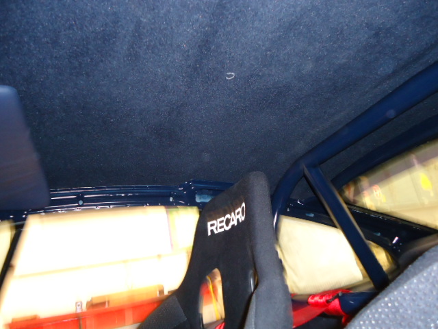

Here's what the removed roof looks like, the whole thing weighs ~33# + actual s/r panel 15# + the bows, motor, trim, sliders & liner 14#
the replacement roof 8#
You will need to put something to finish the inside ~3# for this alcantra cloth
The increased headroom is priceless

Your measurements line up with mine. My bathroom scale said 65 pounds for the roof with the complete sunroof. It said 8 pounds for the new roof skin.
