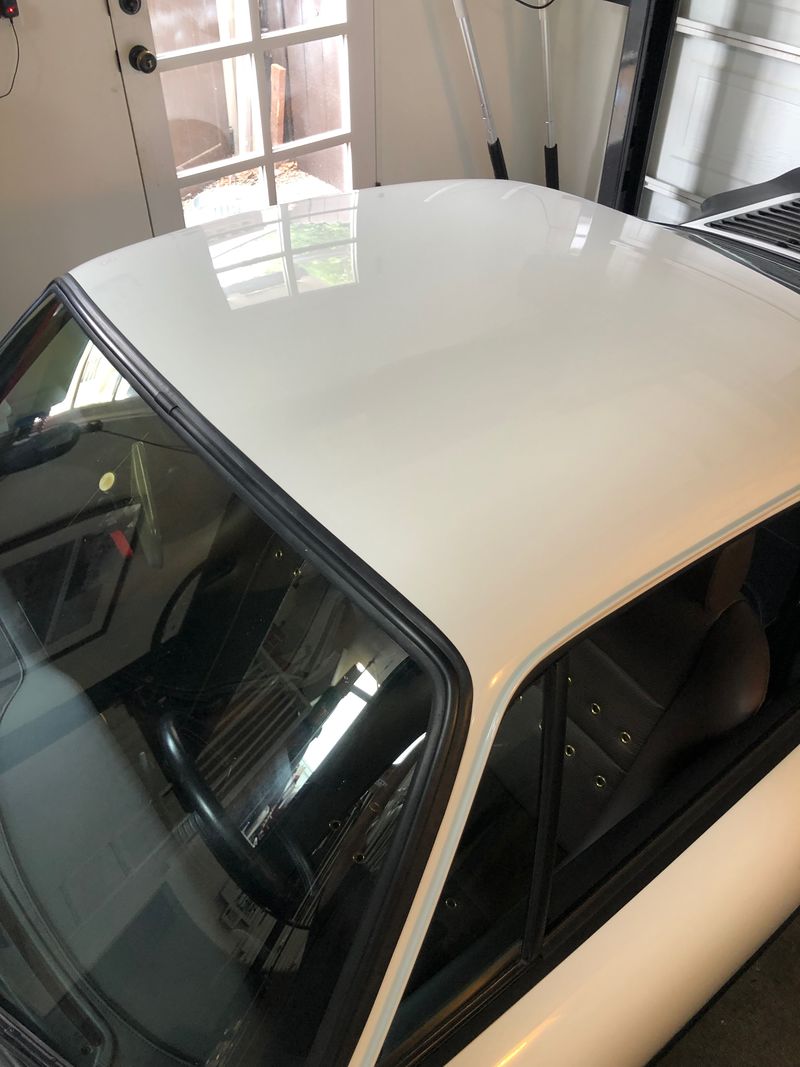

Done. Here is the roof painted. I'm thrilled with the results. A real proper job, this.
If you want to remove your sunroof, I recommend replacing the skin (vs. welding up the sunroof hole). The advantages are there is less cutting, less welding, less body filler, and in the end, it's lighter.

I was PM-ed for some more photos of the completed project, so I thought I'd post them here to round out the thread.
I am thrilled with the full roof skin replacement method. It worked really well for me. The outcome could not have been better. The benefits of a skin replacement are:
1) This is how the factory installed roofs.
2) 58+ pound weight savings.
3) Perfect profile. Identical to the OEM roof.
4) No filler.
"Shaved" bumpers.
New interior. The headliner, which started it all was replaced. Also the dash, kneepads, door cards, rear quarters, pillars, seats, carpets, insulation etc, all in leather.

What a BEAUTY!
Thanks to this post, I pulled the trigger with Perfect Lines. I'm picking the car up, post sunroof-ectomy, this week.

Frank Amoroso, your roof looks great. Perfect Lines is doing great work. They have become masters at roof replacements.

Picked up Vents from Perfect Lines today. I'm happy to say it looks like they did a great job on the sunroof delete...

Indeed. Thanks for starting this thread at the precise time I was A) struggling with the to delete or not to delete decision and B) searching for a local-ish shop that I could trust to do the job correctly.
Also, I originally thought that the roof replacement method required cutting the A and C pillars and your detailed explanation of the roof skin removal and replacement process educated me otherwise.
Now that I see the delete in person, I have zero buyer's remorse / regrets.
