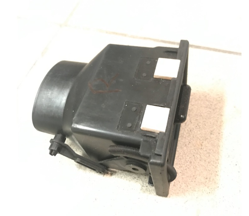

One of the challenges is to have the chromed strips above and below the dash panels perfectly aligned. That would have been easier if I had opted for glovebox-delete. But with the glove box in, the strips are cut in tree pieces from the right door to the steering column. An extra challenge is that the square vents are spring centred, and that does not guarantee a perfect positioning.
So my first exercise is to define a straight line that spans the das from left to right. Using that line I can then position the vents perfectly aligned.
It may be an overkill, but I used a hobby laser level. It worked out great.
Once I had that reference line I did modify the outer casing of the vents to fit perfectly in between the dash top and bottom of the dash metal chassis. First went the springs. I then glued on some wooden shims. The top edge of the dash opening must be filed so it is perfectly horizontal (I call horizontal anything that is parallel to the laser line). The bottom edge can be bent and twisted. Now, the vent frame drops in perfectly. I'll need to find a way to fix it, will do that later. Note that when I modify something, I make sure it is 100% reversible, so I can go back to my original dash if this whole exercise fails
Here is the laser level
Used to set the bottom edge of the opening straight, see the red line
springs removed and shims added top and bottom

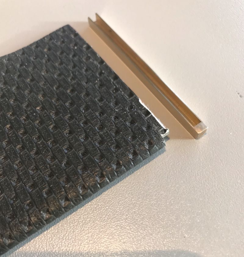

The decorative strips are made from messing U profiles that I will have chromed. The panel is made from PC board. The fabric is vinyl from a VW seat, but used in Porsche too I think. This is just a test fit to see the effect. I did look for the leather basket weave the Singer is using, but at the end I found the vinyl more in line with the styling I wanted.

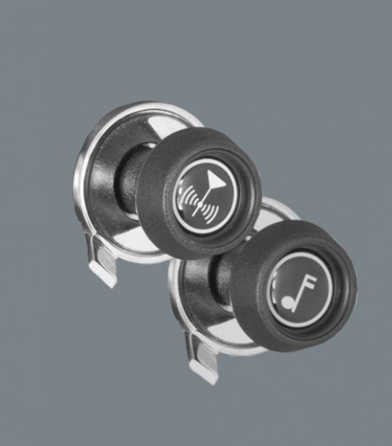

When I decided to go look for a Porsche 911 to add to my (very modest) classic car fleet, I wanted a car that I could drive immediately without the need for a long restoration (which I have done on other cars). It meant too that anything I would want to change, should be relatively wel defined jobs that limit the down time of the car.
For this dash mod, I took the time to prepare the works so as to have all the major decisions taken and parts identified and/or prepared before tearing stuff apart.
One of those decisions was what sound system to install. I drive the Targa mainly with the open top, and then it is a quite noisy experience. Especially at speeds above 40mph. If I wanted clear music at higher speeds, that would require a powerful sound system to go above the driving noise. At least for me, that creates extra ear fatigue as I learned from another car. I tend to record music as a hobby, it does impact my expectations on how 'undamaged' the radio sound reaches my ears. I decided it's unrealistic to expect anything that would satisfy me on a highway, so I focussed on driving around in town and neighbourhood. Nothing very exotic is required so I settled for a Restrosound set retromanufacturing.com. They have this sober classic look, it's not too intrusive when integrated in the dash, and I found that the chrome bezel of a 70-80-ies Blaupunkt Frankfurt fitted perfectly over it. Another hint to the Singer legacy... The sound of the Retrosound is not the best around, but it's ok for the purpose defined. I found some stylish knobs to fit too here retrosound.be/en/?controllerUri=index
Pleasant surprise when I bought myself some Apple AirPods with noise cancellation. I installed an radio station app on my iPhone, and with the AirPods and the noise cancellation , music has never been clearer in my ears even at 80mph. Beats any high end high dollar sound system to me.
the radio installed with the corresponding backplate.
here with the chrome bezel

As mentioned earlier, I prepped and experimented in advance. This is a testpanel that I made to see how it could all work out nicely. The panel itself is PCB, the strips are cut from 4x4mm brass U-channels. The ends are capped off with soldered in 3mm lengths of brass rod. Where the caps are, the PCB has an indent. The vinyl is cut flush here, for the rest of the panel the U channels fit perfectly over the vinyl-PCB giving a nice and professional finish. All the 8 messing strips needed have been cut to length and capped upfront, then sent to the chrome shop (there is a 6 weeks lead time). I actually went for a nickel finish, including for the radio and heater panel surround. That gives a slightly softer look over chrome, goes well with the dark green of the interior and vinyl. The ones in the pictures are not plated yet.
