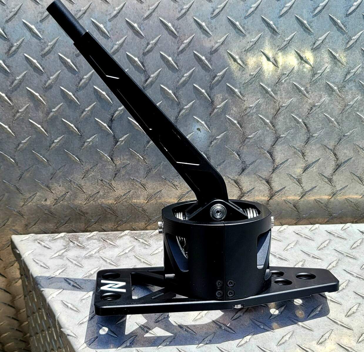

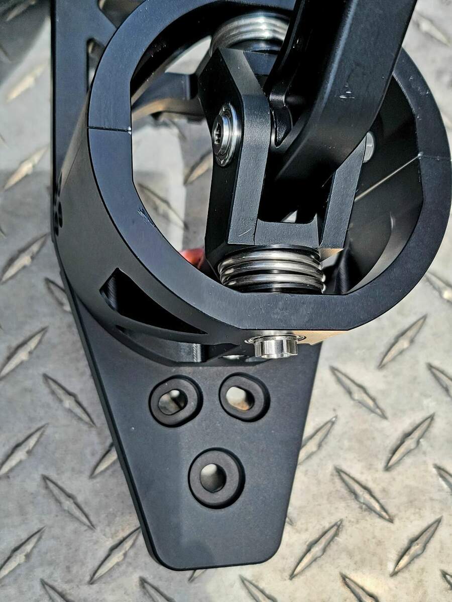

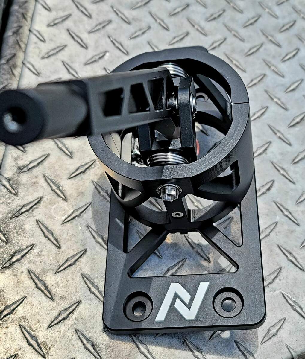

Racerbvd 04-29-2021 10:21 AM
This thing looks sweet, can't wait until the engine in the 914 is freshened and back in the car.

Ok, when the 81 is back together, I will literally be able to test each shifter (will pull the newest out of the 914, which is right ahead of the SC going back together) And yes, I corrected the hasty assembly as I wanted to see how it look together :Dhttp://forums.pelicanparts.com/uploa...1619892290.jpg
I do have a tip to offer for assembly, getting the inside spacers to stay in while lining up the hole is frustrating, so a dab of glue in the OUTSIDE of the spacer holds it in place while you line up the shifter

Initially in the installation video, vlad installs the lever backwards, then magically it gets flipped around once he installs it in the car.
The three holes in the housing go to the rear, and the lever should angle back..
