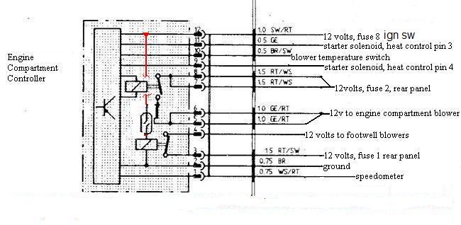

socal911: I have used a trickle charger on my '85 as I don't drive it often in the winter here where they use salt on the roads when it sleets or snows. Should I disconnect the battery when I install the trickle charger to protect the footwell blower relay?
I checked one blower and it runs well. I suspect the other does too. All 3 fuses are good at the engine compartment relays.
I do not have fuses at the footwell blowers nor does a large fuse in the front truck fuse block control these blowers per the manual.
So, my next step is checking the relay. My Bentley manual is not much help. It does not identify pin no's on the relay nor outputs to the footwell blowers. I assume I'm looking for a 12V input coming from the levers in between the seats (I know they work because the engine compartment blower works), and a 12 V output to the footwell blowers. Again, I don't see this per the wiring diagrams in the manual.
Does anyone have a procure for checking out this relay?
Thanks.

This diagram might help. The red line is a correction to the original diagram that has circulated for years.
You will have to open up the unit to examine & test the relay for the footwell blowers since it operates with engine blower current flow thru the reed switch. There is no way to operate it externally without the engine blower connected and running.
