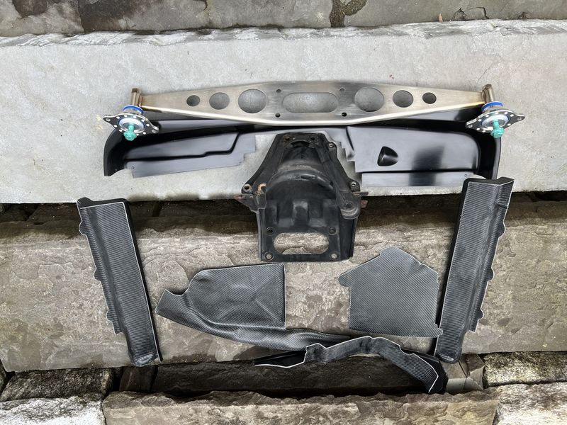

This was mentioned earlier but IMO a big issue is the way the 3.6 is mounted in the car
Method 1 using the 3.6 console, cross bar and engine tin
requires that the rear be spaced down 1+" This causes any std. exhaust to hang low giving a droopy drawer look to the rear,
using a GT3 exhaust in the set up it is easy enough to place the muffler up where you want it and then 2 short pipes to connect to the headers are also easy enough to handle
i had some custom pipes welded up decades a go that did the same job connecting B&B headers to a Flowmaster muffler it looked great.
When i needed to replace the system the fabricator had died and there was no one else nearby to do the work, So back to an off the shelf setup.
I bough a Fabspeed RSR system w/ some minor tweaks to the application done by Fabspeed, back to the droopy drawer look.
method 2 using a 3.2 console, crossbar and Sheridan f/g
the Sheridan f/g is custom made for the 3.6 in an early chassis w/ the 3.2 parts
This eliminates the spacer and the engine sits the same as a garden variety 3.2 Any off the shelf exhaust will fit as designed.
I still highly recommend the Fabspeed for fit , quality and sound they even provide for heat
You will definitely want to drop the engine to switch from method 1 to 2

I did this. I found someone who had amber FG tins designed to mate teh 3.6 to the 75 body. My engine still needs some spacers. The tins are parallel to the body, and if I remove the spacers in the back the tins are angles so the rear is close to the body, and obviously the front is in the same place. I did not do this conversion. I have heard there is a spacer for the tranny mount....maybe mine is missing to drop it down? My car originally was mounted using method 1.
Interesting
Using Method 1 the thing that forces the spacers is that the 3.6 tin even modified is so tall that when it contacts the chassis the engine can't go higher.
look at the 2 pics above of 2 different 993 engines you can see how high the 993 tin is compared to the Sheridan f/g designed for the swap. W/ 964 there is the additional problem of the f/i stack height which is greater than that of a 993 engine, This may be another different reason for spacers. Way back when I first had a 964 in there and that was the genesis of the method 1 install.

also interesting, Don't know if I got lucky or if Joe just put together a special system for me( we do go way back together) but there is absolutely no drone, it sounds great but also not too loud, I can actually hear the engine fan again after 20 yrs of just exhaust roar.\
did you use the aluminum 993 console w/ the Rennline cross bar? I hadn't thought of that, I just assumed it wouldn't work, also did you use the Sheridan f/g tin?
The main tweak to the Fabspeed was 1" extensions of the exit pipes to match my bumper cutouts.

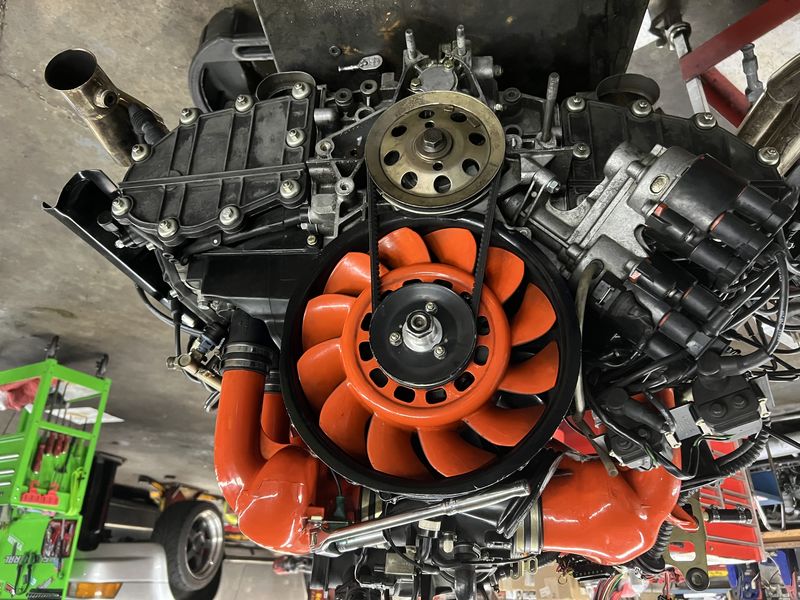

Got the engine out and started the f/g and console install, shorter studs are needed for the 3.2 console vs the 3.6 version
new plug wires while in there, it never ends
Bill Verburg

Engine is back in, the 993 nvr fits like a glove w/o any spacers
need to redo the heat though, that's a bummer

finally figured out how to post on U-tube
993 engine in "76 Carrera 3.0 chassis w/ Fabspeed RSR exhaust
Bill Verburg
