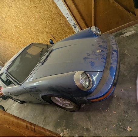

Hi everyone, I'm Brian and I'm a longtime lurker but this is my first thread. I've been a car enthusiast since I was a teenager, and I just turned 40 this year. I love to tinker on my cars on the weekend in our two-car garage.
This thread is about my first aircooled Porsche, a 1977 Porsche 911S that I picked up locally. It spent the past 10+years in indoor dry storage in nearby Lexington, NC. It was originally Ice Green Metallic. I wanted to find the car with the best bones I could in my budget. The main thing for me is that it has a super straight rust-free body, as I am not a body guy. I can mig weld but it's to everyone's benefit if I don't need to often. It was repainted in the 90s with a Maaco special which is failing. Looks pretty good from 20 feet away but not so great up close. Also, it has a 914-6 engine in it which I plan to sell and replace with probably a carbureted 2.7 or 3.0 but we will see. As for my goals with this project, I have very plain taste. I would like to redo all the mechanicals, get the car reliably running and driving (and probably hot rodded a little), lower it some but not aggressively and get rid of the 90s interior additions. Beyond that we will see as we go. I work full time, have a wife and teenage daughters so I will typically work for about a half day on the weekend and update the thread weekly as I go.
Prior to this project, I've mostly had VWs, specifically Mk1s and Mk2s although I also had a Beetle and Karmann Ghia. I finally got to a place in my life a couple years ago where I could fulfill a lifelong dream of owning a 911. I bought a 996 which you can read about here if you are interested: My Arctic Silver 99 C4
I owned it for about a year and a half and really enjoyed it but was running out of things to tinker on, so I recently sold it on Bring a Trailer.
A couple of my past projects include this CC on airlift suspension and a 1977 VW Rabbit that I picked up in Georgia and got back on the road which you can read about here: 1977 OG Rabbit but there have been many others. People always ask me why I put so much work into cars just to turn around and sell them when I am finished. I guess the fun for me is mostly the problem solving, time in the garage working with my hands and figuring things out. Once I run out of things to work on, I tend to lose interest and move on to a new project. Thankfully, this 911S needs a lot and should keep me busy for a long time.

Update 8/27/23:
This weekend I replaced the shifter coupling and shifter bushings. The coupler was toast. After I adjusted it, I can shift through all the gears in the old 915 now. I was so thrilled I took it for a quick maiden voyage around the block. I also replaced the trim above the hood with black instead of chrome and replaced the center dash vents that were broken. Wanted to get more done but it was in the upper 90s all weekend and my garage isn't air conditioned. More to come next weekend.

Did the shifter bushings on mine this weekend and now I can find all the gears instead of just one! I can already tell I'm going to love wrenching on mine too.
