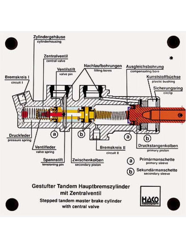

It has been a few years, but when I was involved in a 73 RS type race car build, I sourced a 944 aluminum stepped master cylinder instead of using the normal go to 23mm. Pedal effort was less than the 930 as I remember. Worked great with the caliper combination ..had 930 fronts, rears were a smaller Porsche aluminum caliper, I don't recall which one. It took some work for mounting it and clearing the 15" wheels.
The stepped m/c 's are a poor mans alternative to a twin master setup w/ less flexibility and much lower cost
Oh, interesting, had no idea that the 944 M/C used differential bores. Although I found this drawing some time ago that clued me in that the 993 did:
Does anyone know the specs/sizes of the 944, 951 and/or the 993 M/C bores? I'd presume 964 probably also used them? And perhaps the RS variants used interesting ratios?

The specifics on the 944 brake master up to the end of 86 model year are 23.81/19.05
87 model year was 23.81/20.64 Both are stepped aluminum
