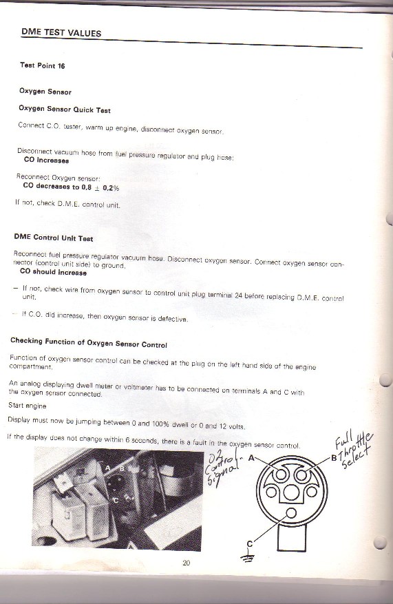

Also, the DME has a self test pin to test O2 circuit. See bottom of this page scan.
Pin A of test connector goes to DME pin #12 and that's a special output just for testing that you are indeed in closed-loop O2 mode.
And for the rest of the testing on the page if you don't have a CO meter you can easily use a WBO2 gauge instead
