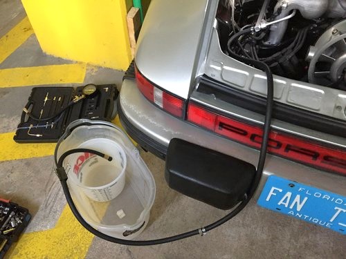

Originally Posted by Discseven View Post
Interesting. Thank you 76. In this case, measured flow is what makes it past regulator.
Am looking at Porsche Technical Specifications booklet. Page you show is not in there. Is that the large format service manual you have? Is there a volume indicated for the 30 second flow?
What this test is measuring here is the pump max flow, and it appears that the pump is good. No regulator is involved, since engine is not running. Pressure regulator and damper work only with vacuum produced by running engine.
Also, injectors are not involved in this test. Again, because engine is not running, injectors are bypassed and not actuated. They are closed and fuel running inside the rails is skipping the injectors.
I can send you a copy of the spec book pdf if you want. I have it OCRed, which allows for text searches. PM me your email if you want it.
Gilles
RoW 88 Carrera coupé
Pressures measured at stock rail port:
Pump ON, engine OFF. Air is bled. Calling this 38.5 psi. Spec = 36.26 psi +/- 2.9 psi Within spec. "Spec book" am referring to here is page provided by Ivan --- TY.
Engine now at idle. See this as 34 psi. Spec = 29 psi. Over spec by 5 psi.
Assuming test gauge just used at rail is correct, installed Radium gauge in fuel line is off (high) 3 psi.
Flow test. Hose is connected to rail port. Pump ON for 60 seconds. From spec book, 60 second flow is 1,700 cc / 1.79 quarts. Being at at 3.5+ quarts, flow is measurably over spec.
I have original Bosch injectors that were removed from engine in 2020. Given uneven look of plugs and down pipe temps, am leaning towards Lucas injectors being questionable.
Yes!
This is not entirely correct. the test is actually testing the fuel flow at engine off rail pressure which is ~36 psi. the fuel flow created in this scenario is the amount of fuel the pump can push at that rated pressure. This specification is drastically different than than asking for fuel flow at 0psi.
For instance if you have a fuel pump for a carded engine (~5psi) and you test it as described earlier in this post with the fuel rail open you may get a result around 2 g/m, however if you use this same pump and test it on the outlet side of the regulator which requires 36psi to open, you will have 0 fuel flow since the 5 psi generated by the carburetor pump is insufficient to force the fuel through the regulator.
the idea of this test is to test the minimum flow produced by the pump at the maximum fuel pressure (no vacuum at the regulator).
This statement is wrong. the vacuum supplied by the engine to the regulator specifically lowers the fuel pressure. The highest fuel pressure is when there is no vacuum supplied to the regulator Either engine off, vacuum source disconnected or effectively at WOT.

Yes, sorry for the misconception and wrong information. I overlooked the test setup and thought the fuel flow was measured right at the feed line.
Thanks!
