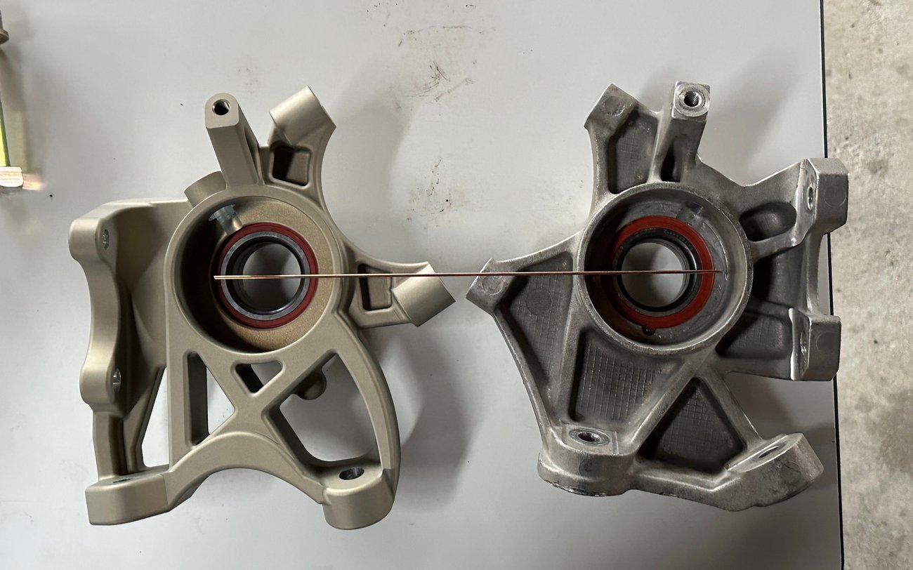

I am not familiar with Nitron. Though I see they have a wide selection of offerings acrsoss cars and motorcycles.
The machining could use some finer finish passes but that is clearly a far from finished part. Not sure how I feel about the bolt on nature of the spindle and toe link arm.....

Looks like a 3d printed sample - can't wait to see that finished product!

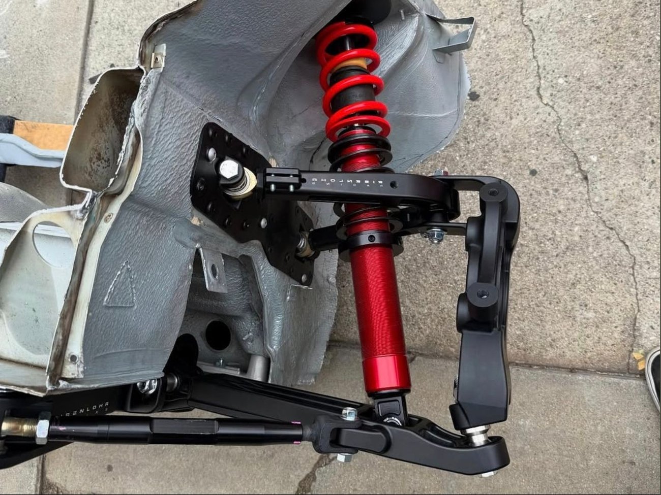

As seen at ERP's Air|Water 2025 booth...
...The upper A-arm mount is pretty slick, but I can't imagine many 993 owners will be cutting up their chassis for it. OTOH, I've driven a 993 with, among other things, ERP's RS uprights, on the road and at the track, and I'd be DELIGHTED to have that setup on a 993, if I can ever afford one. ;-)
ERP upright (a.k.a. legit suspension p0rn) slated for a 964 RS...

Yes, relatively unknown in the Porsche world, especially the air cooled hemisphere. They have had Lotus offerings for a long time, single, double, triple adjustables, etc. I had double adjustable, remote reservoir versions on my Elise track car for 14k miles and 100+ track days. They were excellent, both more comfortable (even with considerably higher rate springs) and provided more body control than the Lotus factory Bilstein Sport package suspension. I did have them rebuilt at that point, but I am totally happy with their performance / longevity, given the severity of my use case.
Yessir. That's a 3D printed item.

yeah, my 993 has the RS/Cup/RSR uprights, Cary's raise the spindle another ~10mm
They had a teething problem w/ the early bearing retainer plate bolts, looks like that has been rectified
