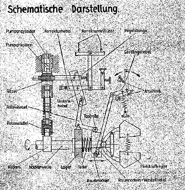

Here's a control diagram for the EP/RLA regulators. It provides a great visual explanation of the function of the regulator.
(C) Robert Bosch AG - for educational purposes only
A few (rough) translations might help
Raumnocken = Space Cam
Fliehkraftregler = Flyweight governor
Feder = Spring
Tastrolle = roller follower
Regellstange = Control rack
Gestanghebel = control (throttle) lever
Korretureinflusse = Correction influences (barometric cell and thermostats acting on compensation lever)
A note about the compensation lever (Korrektureinflusse) - the thermostat (not shown) and barometric cell (not shown) act on the opposite ends of the "T" lever (at the top of the image), resulting in a change or "compensation" in the actuation signal transmitted to the rack. +/- some amount depending on the prevailing control conditions. The compensation could take almost any mechanical form that delivers a linear change proportional to the control variable - an example is the replacement of the barometric cell with the boost pressure compensator on the 935 to achieve a turbo combination. I assume that in racing applications, the "temperature" end of the lever is simply held in the fixed "warmed up" position. (see Henry's famous warm up screw mod/enrichment device, or the top of an RSR pump for reference)
Also, note that the spring shown between the flyweights (holding them "together") is analogous to the spring/screw set of the capsule (low speed/ high speed and idle/CO) controlling the linear position of the space cam with changes in shaft speed.
The spring shown pushing the space cam towards the follower is the very light spring behind the space cam - its only purpose is to keep the cam against the governor flyweights.
Again - these are just my observations/interpretations - please don't take them as gospel.

Old 01-13-2008, 09:28 PM
Location: Higgs Field
Posts: 22,774
Well jcge, even if your conclusions are not "gospel", I arrived at the same ones looking at that diagram.

Originally Posted by jcge View Post
Barometric Cell test spec - 0.58 mm / 100mm Hg ( where 727mm Hg = 1 ATM = 14.5 psi) (no paper document reference...just verbals) I have no reason to doubt this but....all care..no responsibility etc etc
Hmm. . . 100mm hg =1.93367747 psi. So you're saying that when the pressure drops, the elements inside expand, pushing the pin further out of the cell. This makes sense to me, insofar as if you remove the cell entirely, the engine runs excessively rich. So when you climb in altitude the pressure drops and the pin extends, leaning out the mixture.
John - Correct - consider the function of both control elements acting on the correction lever - the thermostat and barometric cell. (What i've called the correction lever is not strictly true - the "real" correction lever has the elongated hole and is actuated by the short "H link" - but you get the idea.)
Thermostat - when it's cold (richer mixture required), the lever is at its highest position. When the engine's warm, the thermo discs have expanded and pushed (via the small 90 degree cam) the correction lever down until it bottoms out its end of the lever (leaner)- . The critical setting here is where the compensation bottoms out - i.e. define a "warm" engine. If the compensation did not stop at some point (bottoming out) a hot engine fed leaner mixture gets hotter until some major damage is caused.
Barometric cell - at higher atmospheric pressure eg sea level (more 02 to burn) a richer mixture will be required - so at increased atmospheric pressure, the pin in the barometric cell retracts 0.58mm / 100mm Hg of barometric pressure increase. Hence the rich mixture when you remove the cell from the unit. (do a web search on "aneroid barometer" or "aneroid cell" to see how it works inside) The critical setting here is for 1 standard atmosphere - achieved by washers under the baro cell.
Several engine builders of repute have replaced the baro cell and/or thermo units with simple set screw devices to meet the requirements of their particular application(check out Henry's 2.8SS motor for example - no baro cell http://forums.pelicanparts.com/showthread.php?t=239210 , and RSR applications - no thermo compensation)
Pushing the correction lever down at either end will result in a leaner mixture. The various distance ratios (lever rule) determine the total degree and proportion of compensation signal ultimately delivered to the rack. So the thermo and baro compensation base or "standard" settings must be set together during a pump rebuild, to ensure their correct relativity. (refer to dimension "c" in VDT-WJP 711/1 B Suppl. 2 Ed. 2 Figure 1 http://www.pelicanparts.com/techarticles/911_MFI/Bosch%20_More_MFI_Repair_Instructions.pdf)
It shouldn't be too hard to map the actual delivered values for each control signal - just need to put a dial gauge on the end of the rack and replace the control in question with a screw and dial guage and create an XY plot - the "transfer function" of the control element.....(hours of fun for all the family)
A logical extension of this mechanical arrangement could allow for 3 compensation variables (as opposed to 2 used by Bosch in this application), by using a triangular plate with articulated pin in the center - each control acting on the 3 corners of the triangle, and the sum of the inputs delivering compensation at the articulated pin (by superposition) ...but lets learn to walk before we run...and stick with what Bosch gave us !!
