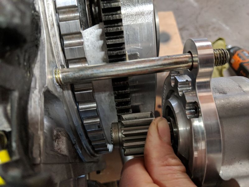

I'm having some trouble with a high torque starter. Chewed up a ring gear, triggering an engine drop to replace it Hoping to confirm that the 993 tip starter will plug in without modifications and will mesh with the ring gear 100%. Can someone please confirm?
The IMI 101N starter was modified with a different starter gear but I'm not feeling very confident about it after trial fitting it.
My setup is: 1975 911s, 3.6L swap, 915 trans, PMS flywheel, Sachs power clutch. New ring gear is made by Kennedy Engineering (KEP) which should have identical dimensions to factory ring gear, but with hardened steel.
In this first photo, I'm holding the damaged ring gear. This was with the original IMI 101N starter (starter gear had 9 teeth)
In this second photo, i used a red sharpie to mark where the starter would basically sit when mounted.
Positioning the starter with that red mark and engaging the starter, you can see it only contacts about 70-80% of the ring gear. This is with an 11-teeth gear that I was under the impression would fix this issue. The mounting place was also replaced to account for the larger diameter of the 11-teeth gear.
Thank you in advance.
I still can’t confirm fitment, but your wear pattern looks similar to what I needed to address, though mine was more circumferential:
what did you end up doing?
That starter, it’s worked great. I just can’t tell for sure if it will work for you- I have a 993 G50 gearbox, etc, so quite a different install.
