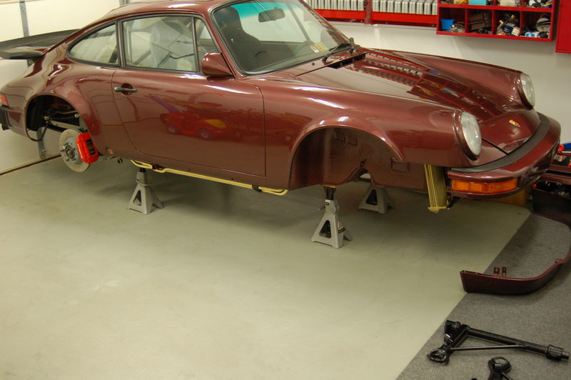

I just installed and indexed the front mounts - so this looks easy - in theory. I think I bought the wrong clamp. I got the HD special with the twist handle with no crank type handle so I got monster blisters. The deal with these cheapo clamps is that they only work so far... then you need to reset the clamp(the screw) is not long enough. Chuck's tools, instructions are spot on, I didn't have an extra set of hands (well actually I had 3 sets they are just attached to a 4 year old, 3 year old and 8 month) and had that cheapy clamp which made it harder than need be. Anyway, got those done and they are "resting" for the evening. 21 in the front and 15 on the rear. I hope I did them right.
As for the angle on the rear plates - good question. I have no idea how much my car weighs...stock Carrera with nothing in it - the sky jacker photos above will show how high it was sitting at the stock suspension height and no weight in it. It has a Patrick Racing roll bar...35-40lbs? So any guess as to the weight I should start with?
I have a few parts being powder coated and I am waiting on new spring plate bolts from our host. I got lots to keep me busy in the mean time - here is a pic of the A-arms - they look right eh?
Does this clamp look right?
This clamp is def not right - (don't get this one)
parting shot
Jeff

The clamp is right, the rubber cushion is just too thick for that application.

I am pretty sure the problem is that the white spacers belong right under the bolt head (providing the proper spacing for the rocker panels---bolt head, rocker panel, spacer, in that order).

Yeah the rubber spacers/bushings seem pretty fat - got them from our host. They are a bit thicker than what I took off.

84 Carrera should weigh 2760 lbs with a bit of fluids.....a rear section roll bar is about 40-50 lbs. Some advice....."garbage-in/garbage out" as to setting the rear suspension angles. I worked up the angle calculator and people here who've tried it says it works fairly well.....but ya gotta get the weight right, it can be pretty sensitive to this.

Right - I am guessing I have taken out anywhere between 400-450 lbs. The list exhaustive and extensive - it all adds up.
I do have the ASP's in the rear that makes things easier so I just need to be in the ballpark and can adjust from there.

Get the car on a set of scales if a lot ( and a lot of "uncertain amount") of weight was removed. The ASP's will only take you so far.

I hear ya Wil - but the car has no suspension on it as of now...so it's like the chicken before the egg or.....? I will have to guestimate.

Lopped off the ears on the other side and drilled and tapped for the set screws on both sides...I hope the fronts go on with no "mods"
Parts now only on one side of the garage with lots more to go...

Hate to say it, but it appears the front bushing on your left a-arm is indexed the wrong direction. I bought the same bar clamp and could not get the bushings to set. The bar would start bending. I went back and bought the long pipe clamp fittings and a 3/4 inch pipe (for only a few more bucks) and it worked like a charm.

Thanks for the heads up - you are correct. I fixed this last night as the soap still had some movement in order to tweek it into the right position in the other direction. That would have ruined my day when I went to bolt it up.
