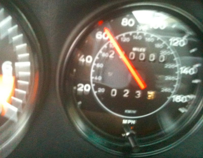

When my car was ready to roll over 200k miles I planned it out so we could take it out early Sunday morning and it would actually hit 200,000 on a section of freeway that is always pretty empty.
I have a rather shaky video that shows it rolling over at 145mph as it is just short of red line in 5th. So yeah, change the oil regularly, shift it correctly, and once it reaches operating temperature drive it hard.

Like this? The needle is over a "3."
Unfortunately, having bought this '85 at a dealership and getting no records, I do not know what's happened in the past. I did some investigation with two shops near where the (now deceased) owner lived, and found only routine maintenance.
