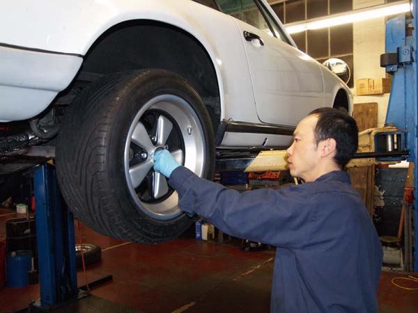

I made a detour to visit daughter in S.F. after Rennsport. Driving after dinner, discovered a clicking sound from the rear or drivetrain and getting progressively louder, but not imminent failure loud. Would like to check it out before the 400 mile trip back to L.A. Will flatbed it via AAA for fear of potential breakdown on the way (e.g. CV joint or equivalent).
Need some suggestions for a reliable shop to take a look. I'm in the Fillmore area.

Like you guys said, Aldo was available, but his new shop wasn't. He's in the process of setting up a new shop, new location. Epoxy shop floor expected today and his shop equipment was in a stack. He suggested The Stable a few blocks away.
The Stable
Nice shop. Lot's of equipment. I met George who told me the owner was recuperating from a stroke. Didn't matter. George was on it. I was hoping for a loose or even worn CV joint. Instead, we found a worn (not loose) RR wheel bearing. Okay. Let's install a new bearing. However, the car owner (me) left the locking lug nut key on the workbench at home (only 400 miles away). That's a big DUH for me. Instead of attempting the "Remove-the-locking-lug-nut-from-the-Fuchs" trick w/assorted cutting instruments, I've decided to drive home at scenic speed. If it gets too loud, I'll ask AAA to flatbed it from whatever milepost marker I decide to end the journey. 100 miles free range is what I have. If I can make it to within 300 miles, it should be okay. If not, it's only a pricey lift home for the magic lug key. My fuel mileage will automatically increase won't it?

Hopefully, here's the final chapter of today's episode.
Here's George removing the cotter pin to see if the axle nut was loose. He torqued it to spec, but it was already there.
I could live with a worn wheel bearing on the road as long as it didn't sound like imminent failure. It didn't and was just fine all the way home, but I checked the wheel temp. a couple of times to see if the hub was overheating. It wasn't.
An afterthought - if I even had a flat tire, I'd be SOL w/o the lug nut key. If you have wheel locks, don't leave home w/o the key. Obvious huh?
For those in the bay area, I'd recommend both Aldo and The Stable; Aldo for taking time to temporarily close up and road test it with me despite having a full plate this morning. He also recommended The Stable once he determined he couldn't bend his schedule.
And George @ The Stable for a thorough look see and confirmation - it was very nominal. Had a nice chat too.
