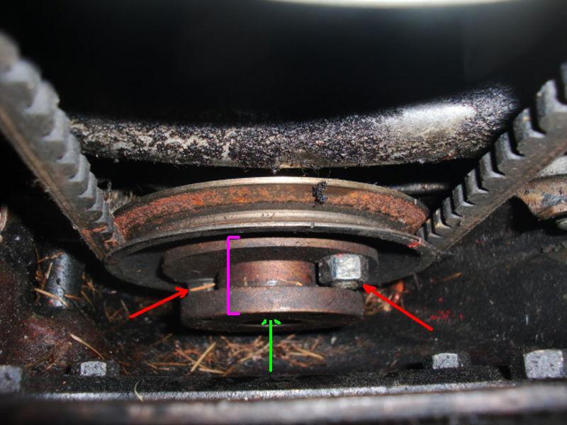

As Joe Bob said, someone did something strange with the original crank pulley. However, it does look like you could get a long flat-blade screwdriver between the center shaft and one of the nuts and turn by prying, again clockwise. It wouldn't be surprising if there was too much resistance to turn it by the fan belt, but could easily be broken free on the crank.
Give that a whirl and report back. Nice project BTW!

The screwdriver approach has potential. Thanks. Tried it but things aren't breaking free yet. I'll let it soak some more and keep trying.

Grady Clay's Avatar
Location: Arapahoe County, Colorado, USA
Posts: 9,032
This (violet bracket) is an aftermarket A/C adaptor.
The A/C pulley (now missing) was originally mounted on the end of the adaptor.
The adaptor is bolted (red arrows) to the original Factory fan belt pulley.
The original pulley-to-crankshaft bolt can be accessed in the middle of the adaptor (green arrow).
You may need to use a ‘deep’ 3/8” drive socket for this.
Install the socket on the bolt and then attach a long-handle ratchet wrench.
Sell the adaptor on Pelican.
Someone will find a use.

Thanks Grady. The PO indicated that at one time there was an aftermarket AC unit in the car. It's long gone but that explains the pulley. Access is very limited but we'll find a way...

How about cutting off the belt and using a strap wrench either on the pulley or on the outer flange? You might need to put a cheater pipe on the strap wrench handle...

Seriously, though, maybe even something like this adjustable handle chain wrench would do the job. Or something like this chain wrench with a long breaker bar. A traditional strap wrench, though, might be better in that the adjustments aren't limited to the size of the chain links.
All you need to do is break it loose, and when trying to do that leverage (and liberal use of Marvel Mystery Oil) is your friend!

The best advice so far on the engine (when breaks are working) is to roll it outside, put it in 5th gear and take the help of some buddies. First, start by having it in gear, gently rock it back and forth (only push on the "forth" to keep the engine potentially moving in the right direction) and check for movement. Then you push harder and harder, until the tires are slipping.
When you feel you have nothing to loose, you cant get it to move no matter what, you could always ask your buddies to push it hard, put it in first gear and release the clutch quickly when you are at speed. BUT, that might break stuff, so be cautious!!!
If the engine is frozen, my guess is that you will break the crank pulley bolt before it moves. Ask me how I know....

Will it turn with the starter? I would try that first. Even with old oil you will not do any damage spinning at 200 rpm with the starter for a few seconds. Just disconnect the CDI unit so that it can not fire.
