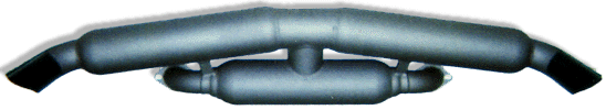

Just completed this exhaust (the silver one)the other day, I had it off tonight to weld on some chrome tips so I thought I'd take a pic, what do you guys think? It's quieter and has a little more midrange feel than the other one which is a 2 in 2 out 2.5 inch Flowmaster with Pacesetter tips. Only downside is that it seems a little softer up top but that could be the cooler weather with jets optimized in 90 degree July. I'm gonna dyno test both as soon as possible for comparisions sake. The only thing I don't like is that I used cheap Summit racing turbo-style mufflers and they're a little raspy at full throttle, I'm looking at other options such as Hooker Aerochamber, Walker Dynomax and Edelbrock. Any ideas or thoughts?

Interesting, sort of reminds me of the old Ansa and Manta muffs

Actually, I've been finding that most performance mufflers are more geared and cutting down the lower rumble of V8 engines and do little for the higher pitched flat six. I plan on cutting these mufflers off and putting flanges there so I can test several different mufflers so I can get the sound AND performance I like. What will I do with the slighty used mufflers I don't like? Sell them to my drag race buddies, as long as it's loud and flows well they're happy

Looks clean.
How do the twin mufflers compare to the flaumeister weight wise?
Does the crossover create any restriction due to reduction in total cross-section?

As for weight, I couldn't believe my eyes when I put them on the pallet scale, both exhausts weight 25lbs +/-1lb
I'm sure the crossover creates some restriction, I've seen them with varying "merge" areas for different rpm/hp levels with smaller merge sections for higher rpm HP. I used 2.5 inch pipe though so it's definately far less restrictive than a stock SC exhaust with it's single pipe to the muffler. Like I said it feels a little softer up top but I jetted my car in the July heat so it might be a little lean with the cool weather we've been having in Ohio lately. I'm gonna check the A/F ratio and possibly install larger jets.

I like 'em! This is a cool and clever way to get the crossover in. Reminds me of the Dr. Gas components. (www.drgas.com). I'm a big fan of crossovers on 911 motors. Definitely knocks down the db level, and seems to particularly help midrange power. Have you experimented with secondary (distance from header to muffler inlet) length? I haven't done nearly enough testing, but it seems like the longer the better.

Boomy, Very nice. You've discovered a good location for the crossover pipe. Care to make me a set without the mufflers?
I've always wondered why, on the 917's, they never used a crossover pipe. Any idea?

Thanks RSR, actually you inspired me to practice more with my new Tig so I could do a better job than the old exhaust that I did with my Mig. I got the idea from the Dr. Gas pipes used on 5.0 mustangs. Due to packaging I haven't experimented much with secondary length although these are longer than the flowmaster setup and the midrange does feel stronger, the dyno will tell.

Two Oh, I'd love to make you a set but... I'd need a car to fit it to. I cut the factory collecters off my early Triad Headers and installed 2.5" collectors so I don't have an exhaust to match up to. Anyone with some spare time and an early car in the Akron/Cleveland area of Ohio that would like a crossover? I'll do the first one free if the owner supplies the materials (about $90 for the crossover and flanges) That way I could make a jig and sell them cheap. I really enjoy welding and metal work as a hobby so this would be a fun little side job for me but of course small production since they're handmade.

Interesting concept and I like it much better than the single Flowmaster. I heard once the larger the can, the better the sound attenuation - so two must be better than one, and since they share the flow, you get half the backpressure in each. Probably the straight through mufflers will net you the best performance, such as the Edelbrock RPM series, Borlas with the lazy S core, and Ultra-Flos. I would imagine a controlled burble at idle, and a straight shot out at full throttle rpm.

Hey, and what about a pair of used 993 mufflers? Supposedly their exhausts are so efficient, yet quiet that tuners can barely extract more than 5 hp extra out of them. The entrys and exits are probably in the wrong place, but with all the creative minds here, maybe something could be rigged.
