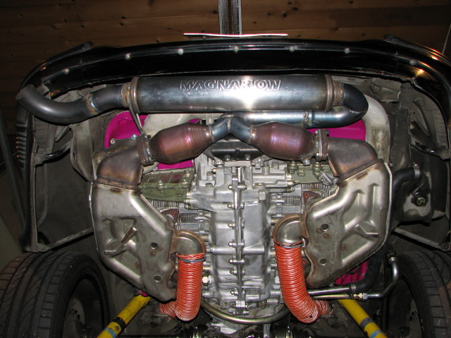

Previously had a 2 in 2 out magnaflow setup which was too loud in and outside the car. It attracted way too much negative attention.
Car is 1972 Targa with 1995 3.6l - single O2 sensor
I don't have particularly good pictures, but you get the idea
Before
The Triad exhaust
After

Originally Posted by 356graham View Post
I'm very happy with my triad exhaust. To me, it is just right amount of sound. I drive the car for commute / around town residential areas and freeway driving.
The Triad exhaust
After
Contact info I have for Dave at Triad
Dave @ triad
(360) 280-6855 cell
triadwest@comcast.net
