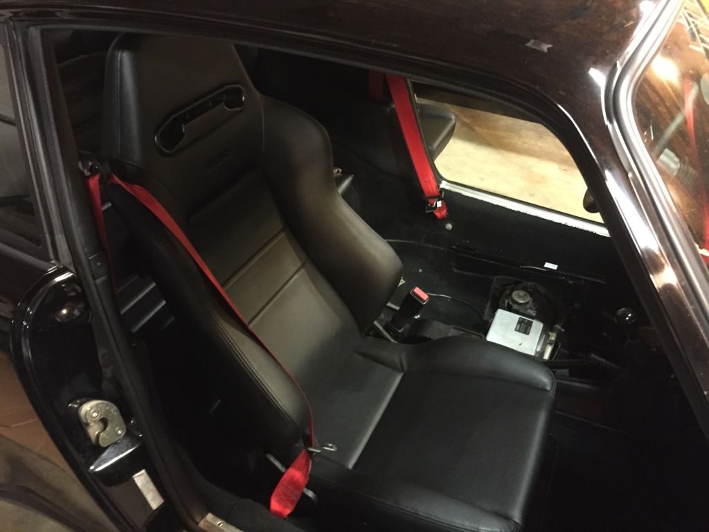

I recently put a custom S08 program set of Recaro Speed S seats in my '85 911. Massive upgrade over the stock seats in both comfort, support, folding, weight, and likely safety. You can order them with center belt provisions as well.

The cabin of the 911 is narrow, which takes out some options. Is there a list of seats somewhere that has successfully been installed?
The shoulder bolsters of the Recaro above are so close to the seatbelt anchor, I bet it makes reaching for the belt a pain.
