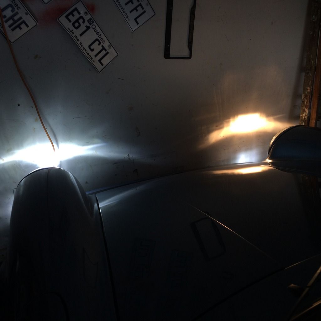

I ordered the 7th gen from siriusled thanks to this thread and installed them last night.
I may have a bit of tinkering to do in order to get the cutoff to be perfectly horizontal, but my question is the following:
With the heatsink taking up some good room in the headlight bucket and the fair amount of wiring now being stored in that same bucket, are you guys worried about the heatsink contacting the wiring and potentially melting it?
Here's a pic of the LED H4 vs the halogen:

If you make sure the wiring don't touch the the heatsinks, you won't have any trouble. I can't imagine them getting any where near hot enough to do any damage.
I set mine up so that the little 'eyebrows' that were over the top of the 2 outboard LED's, which keeps the light coming off of them shining upwards. If anyone else has the 7th gen Phillips LED's from SiriusLED and has rotated them differently, I'd be interested in their opinion. But as it stands, I've been extremely happy w/ the results of mine so far.
People can say whatever they want as to the yellow of halogens and being able to see better than the Whites the LED's produce, and about how other drivers find it annoying, but I get "0" flashdowns from other drivers, and if I can see better, which I know I can, I'll run 'em.
Thanks for the reply.
I placed the wiring as best as I could in the bucket, but I'm not sure if when in place it'll end up making contact. Either way, I don't drive for very long at night so like you said, it shouldn't be getting too hot in there.
I have my 'eyebrows' placed the same way btw!
