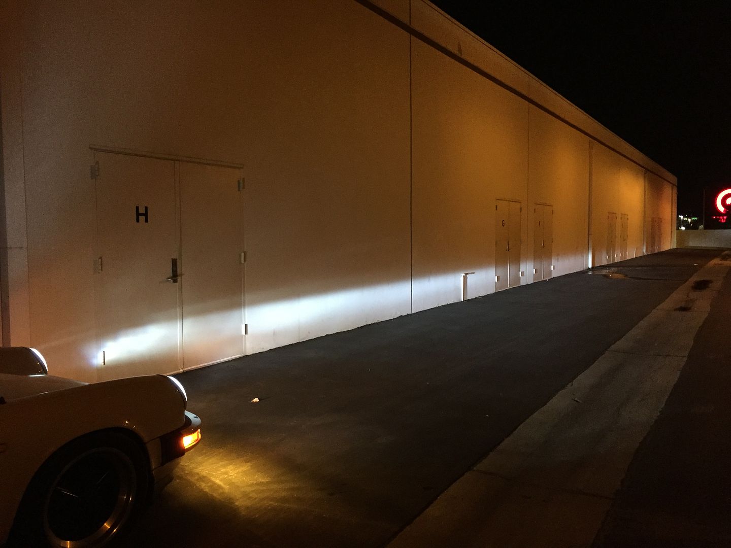

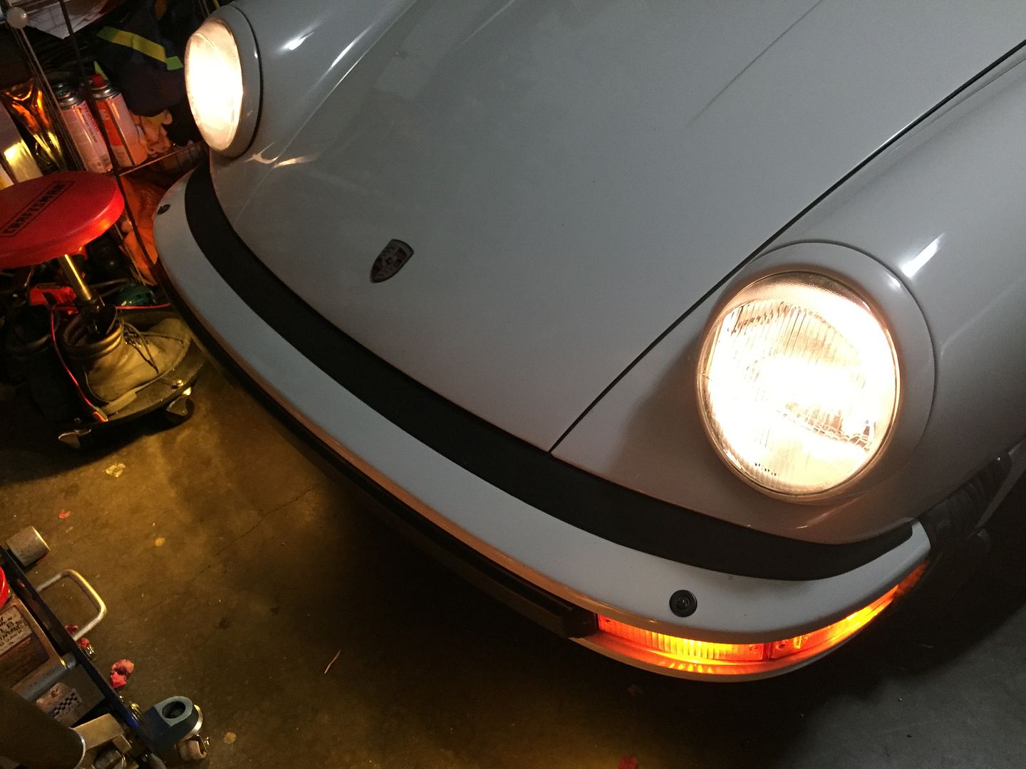

Okay Fellas,
I pulled the trigger on H4's and Sirius LEDs to go with them. I was pretty disappointed with the standard blubs, I hoped the Osram Night Breakers Unlimited would do the trick but only the brights were worth a darn. I could not see at night for the life of me. The funny thing was my camera on the phone could see the casted light but my old eyes were night blind.
Before, the loverly incandescent yellow/natural:
I've been wanting H4s for a long time since my H1s were in a sorry state. P-side was very bad with corrosion, had to resort to HIDs to see. Oh well.
Confirmed Sirius Instructions are Poop, Thank Goodness for Brother Craigerz for his guidance.

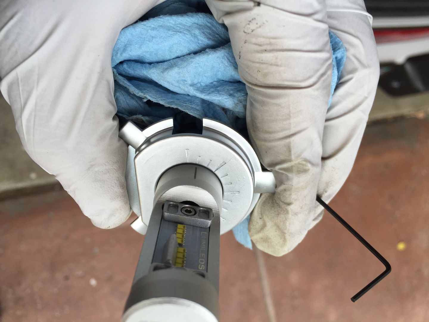

This is how it comes out of the box and they give you an allen key. Set up for our RHD cousins
Loosen two set screws to rotate the bulb 1.75 notches clockwise
To get the proper light Cast ___/___/
Yes, light is clean and WHITE, not blue
I opted to use the supplied double sided tape and mount the transformer in the bowl.
I have to say these are equal to or better than the HIDs, bonus no freakin whining noise from the transformers, no warm up, they are instant on off and the brights too
Build Quality is by far superior than the POS china made ones from FleaBay. Well worth the $109 shipped to door next business day via SF Cali.

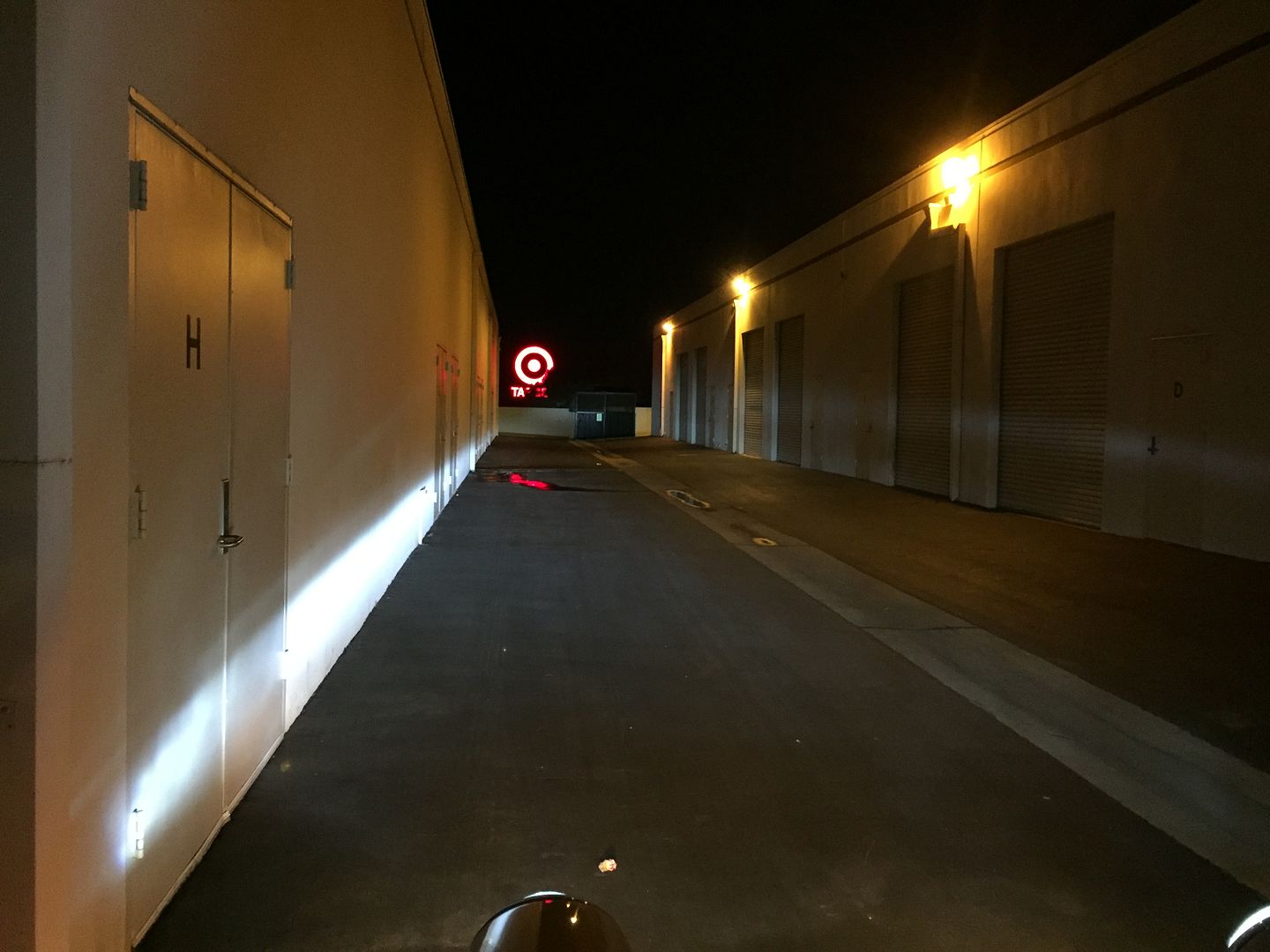

Light Cast:
Industrial Park
I decided to lower it 2 inches lower than standard aim just in case I may blinding some one on coming.
The diagonal cast is brighter than I expected, it sure lights up all the street signs
