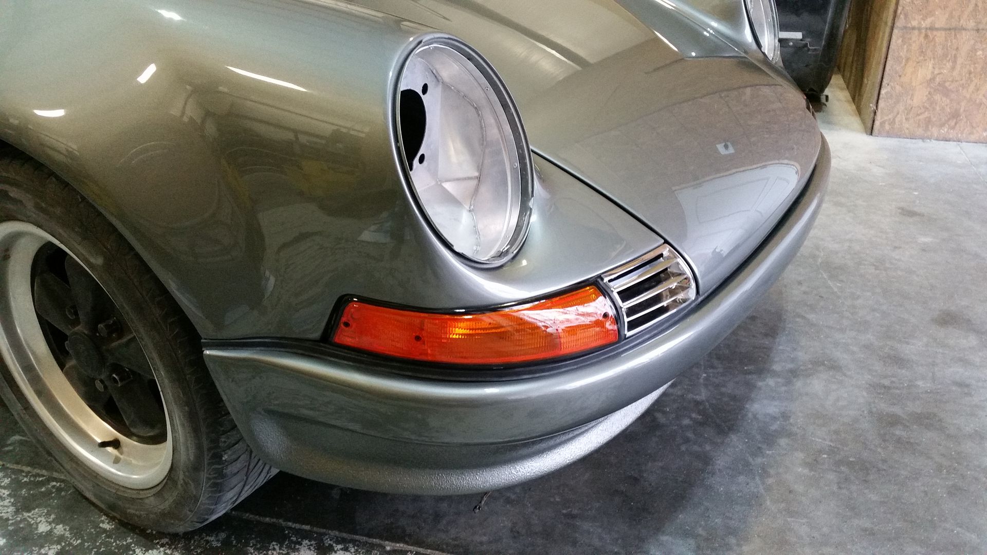

rolfjahn 08-19-2018 05:03 PM
Out of Paint! G50 Factory Wide Body
Finally got it home, going through all the little things that take forever.
1. Check for all loose fasteners
2. Install SpokeLed LEDs for signals and brakes
3. Do the relay and wiring for the Elephant Racing wide mouth cooler assembly
4. Install and wire Closed Course HID/LED Headlights
5. Design install and wire audio system
http://forums.pelicanparts.com/uploa...1534726974.JPG
